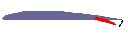

              One way is to physically measure that both flaps go down the same distance. This may be one of the causes of your plane rolling to one side.

                            I didn't do any measurements on my DIY flap/aileron. I just cut and hinge it and then set both servos of the same throw. But that is because my cutout area for the flap/aileron are small as compared to your Formosa II. So, if you do have a big surface control area, that means any little offset will greatly magnifies the problem ( aka roll ).
                            My DIy flaps/ailerons is only 1/3 of the wing span..... anyway, they didn't work effectively enough - didn't roll much . I will modify with a bigger flap/aileron to test again. Till then, I will definitely do what you gonna do today, check and measure
                            I'm Remotely Controlled ...
                              I just move both flaps down and measure the gap. Simple
