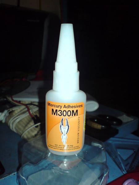

    I'm skipping the whole build process for this mini-review as there's really not much to say. Except that I used the new Mercury Adhesive CA. Great stuff. And I like the cap design. No more untwistable stuck caps. I'm using Mercury Adhesive CA from now on.

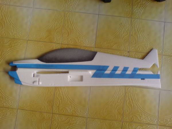

    I started by spraying the canopy. Quite easy but I would learn that I should not have done this step yet.
    After that I taped up the parts that I wanted to remain white.

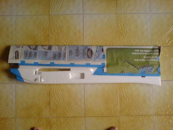

    Then, I covered the parts that I did not want to spray yet with newspaper and tape.

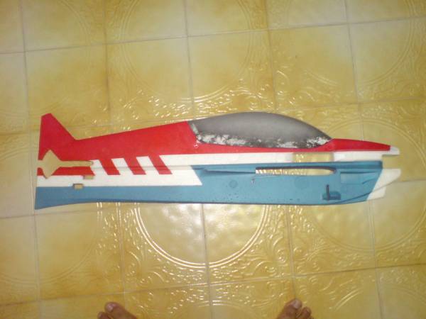

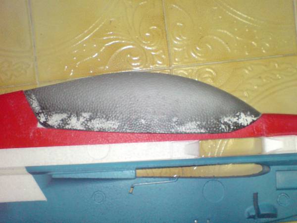

    The spray job generally went on quite easy. Only problem is that the painter's tape is still not low tack enough and pulled off quite a bit of the paint from the canopy. Now I've gotta find a way to respray the canopy again.

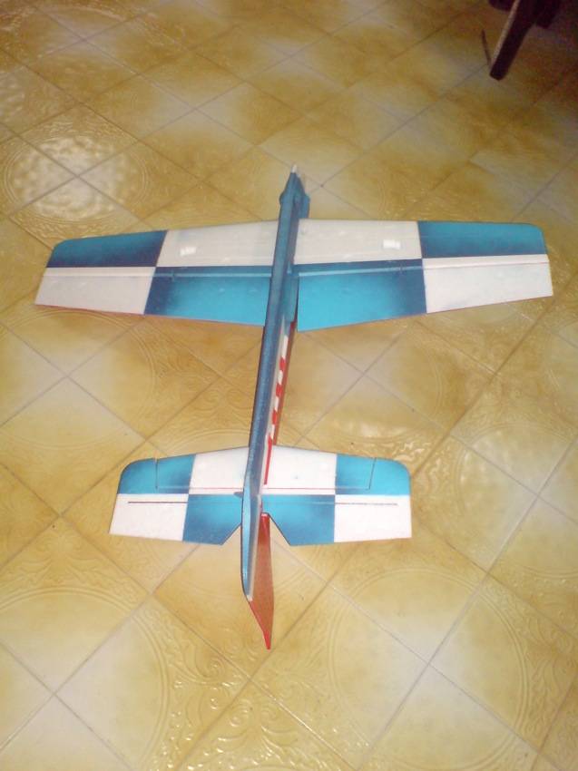

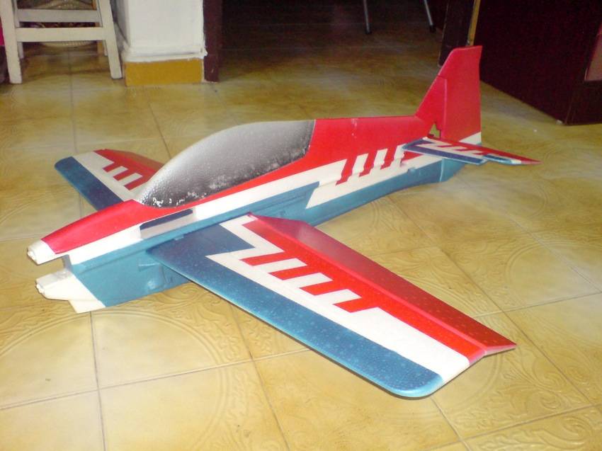

      After a busy weekend with work, I finally got to continue to work on the PM3D. The masking and spraying took me three times longer to complete as compared to the build. But that's the trade off to get a plane looking the way I want it.
      Voila. Still needs some touch up here and there, but it's more or less done. Here's a dry fitting to give a good feel of how the plane will look once it's completed
      It's getting real close to completion. Cannot wait to get this up in the sky. It has been some time since I've flown. My head all healed and I got meself a helmet for my flying sessions.

              Cool job! Just a small suggestion about the masking tape: you can try sticking it onto you shirt or pants before applying it to the surface. This will allow the tape to pick up some lint and not make it too tacky.
