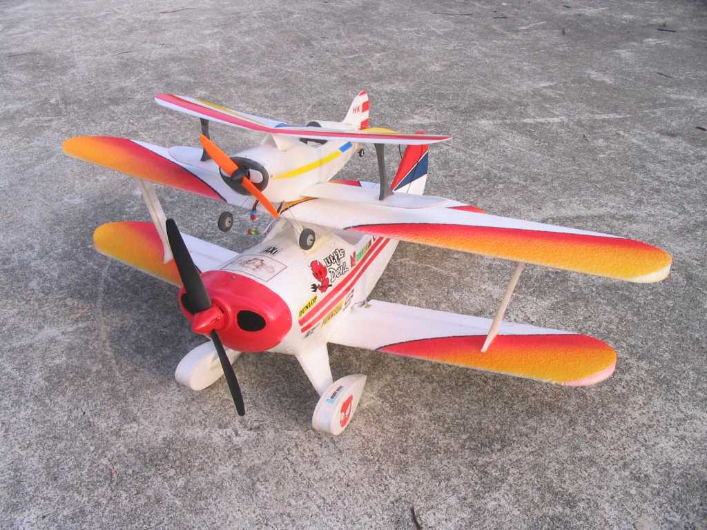

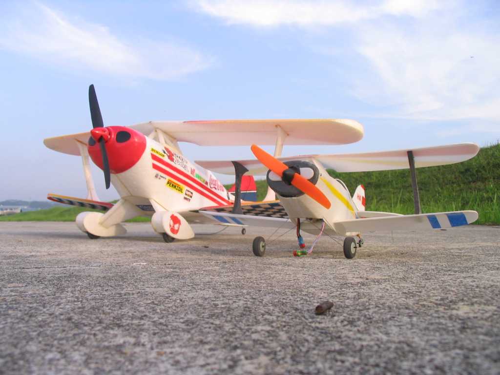

          this is one of my small rc plane ....... side by side with its big brother
          and here is the video
