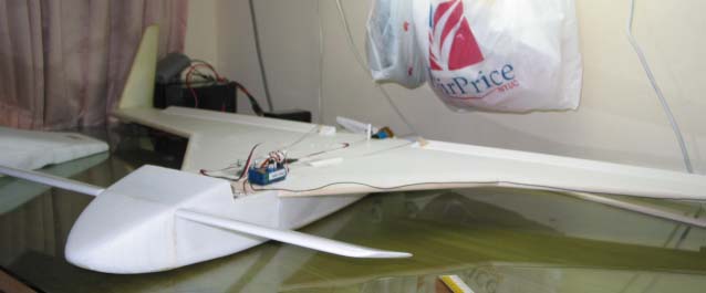

    A little peek into the simple mod i did, 1st pic shows the new 2 aileron servos i installed, they are 4 grammes Blue Arrow servos producing 0.7kg/cm torque, available from Mack/George. Best thing, they deliver to your door step!

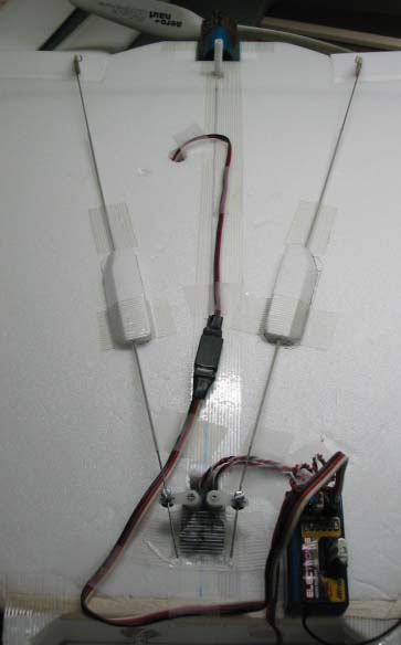

    Want to show in pictures just how the elevator-to-flap mixing does for the Cozy.
    2nd pic is with full up elevator stick on the transmitter, noticed the 2 aileron servos also goes up

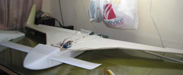

    3rd pic is transmitter aileron stick turning left, simulating a left banking turn, the 2 aileron servos will move like a conventional setup, perfect for the Cozy setup, if you can remember seeing in the video, when i was about to land the Cozy, when i chop power below half stick, it just nose-dived and hit and grass pretty hard, Ouch! It flew well above half throttle during it's firs maiden flight, i must say the r/c canards did not give enough lift below half throttle, above half throttle it flew ok.

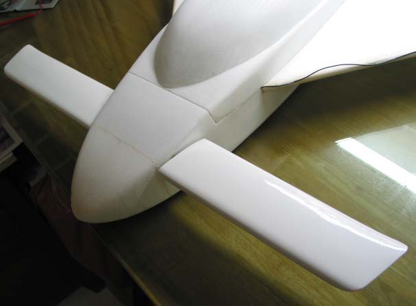

    4th pic, i added new canards, they are now 10mm longer, 4mm wider chordwise and thinner at 10mm on each canard.
    Now with this mod, the Cozy flew fine with a lot of pitch authority at low to full throttle range Phew!
    After this mod, just need a few more flying sessions before i start to air-brush her
