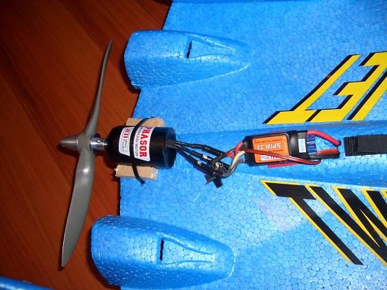

A Twinjet converted to Monojet
After much deliberation on the power set-up, i chose to go the mono way..
Reason: because i have a Jeti 30/3 being left unused for a while
: i have a big pack 3cell 5400mah (low C ) also a white elephant
: i dun want to waste both my spin 33 esc on a twin
: because twin jet body is a fat pig. too draggy, so no point going twin on a mega 3 turn. i have a Dynamic 400 for the high speed passes thrill
Specs :
Motor - Jeti phasor 30/3
esc - Spin33
Batt - electric power 3s5400mah
servos - HS81
RX- hitec electron 6
Prop 9x8 apc
performance : pretty quick, verticals are pretty good (a speck in the sky within seconds) . not very loud , due to large prop.
endurance : flew 20minutes, only used up 2800mah. should be able to fly a 30 to 35 minutes flight with moderation on throttling with my 5400mah pack.
Overall : nice quick set up.
