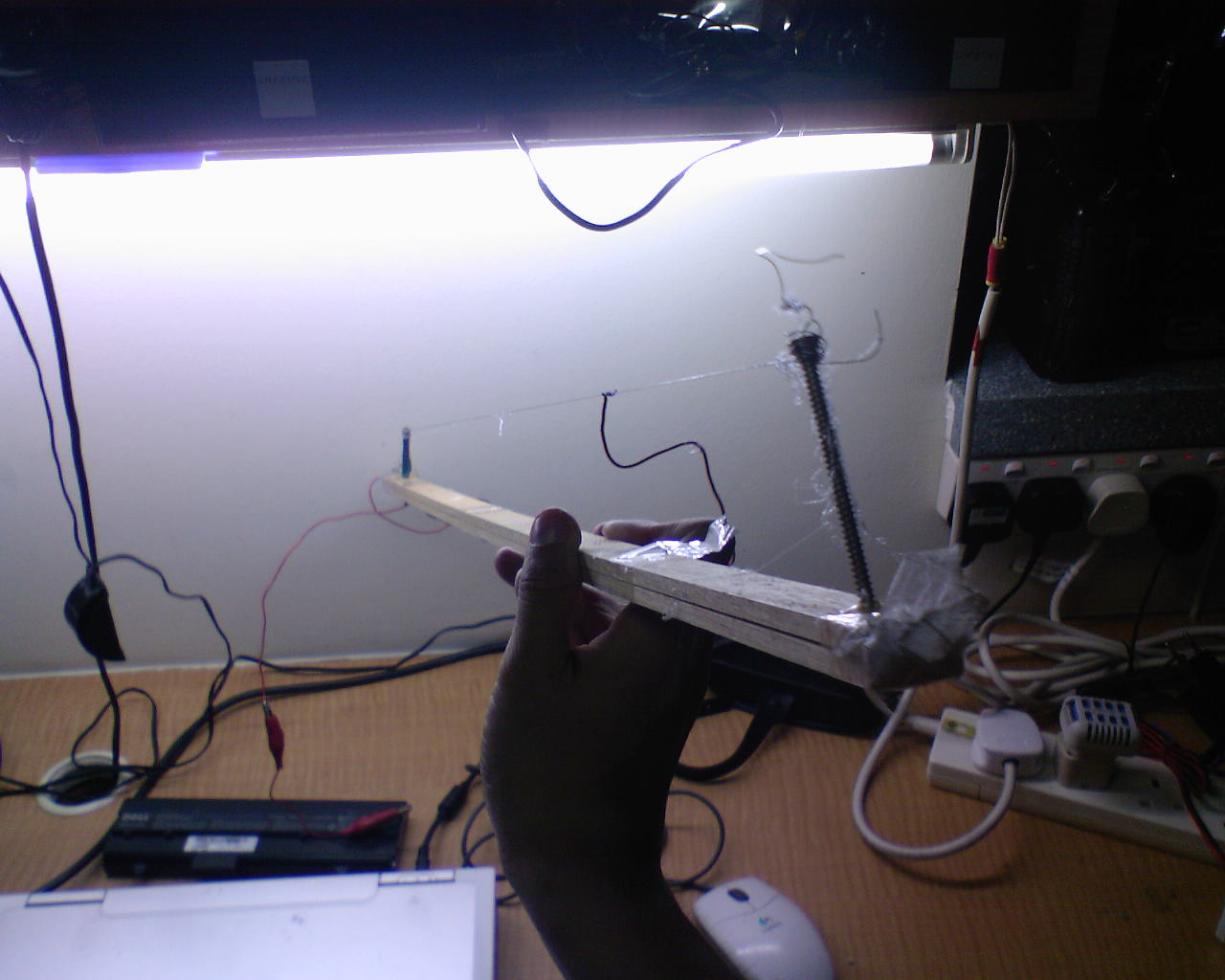

          I'm building another one. Coro again, to get rid of my surplus. Viper, I'm half serious about paying you to do a simple foam cutter for me.
            Haha! Well, when ur pretty sure you want one i seriously don't mind making it for you!
            Want the specs of my wirecutter?
            My its just a simple line tensioned just 5cm away from the holder. Kinda different from other people's wirecutter because the distance of the wire and the holder is very close, but i get more accuracy in cutting (well,thats my opinion)
            I'm using the thinniest garden wire i can find from DIY store. $2 for 20meters. takes me like forever to use them up!.
            Can varies in heating temperature by simply changing the length of the string by sliding the ground wire that is on the heating element. very much like a gigantic sized potentiometer... from around 70 degrees to er..i have no idea but the wire is glowing red hot.
            Oh..and my dc12V supply comes from my esky charger adaptor ..haha.
            So you want one? Haha..
