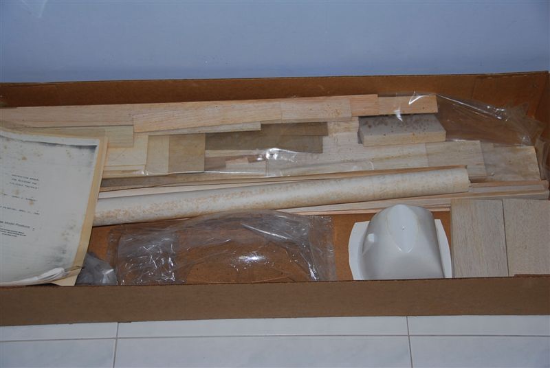

                The manual is really old school... all wordy and no graphic illustration. That's why my build is slow.
                  Took one day to arrange and count all the parts according to the parts list.
                  Not all the printed part on the balsa can snap out nice, had to do a lot of cutting to get them out.

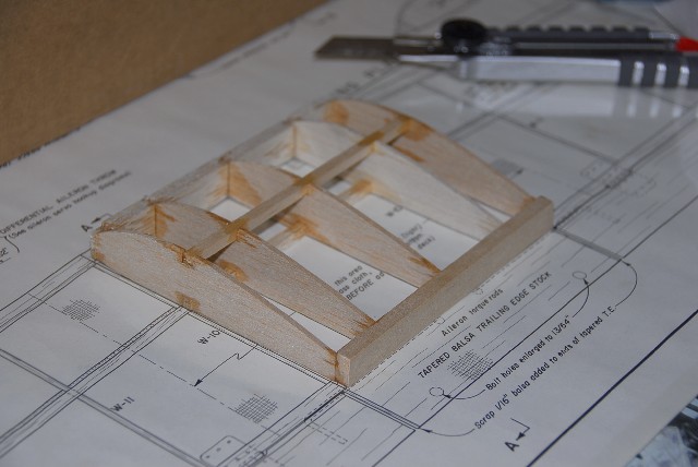

                    As promised. one rib a day. 5 days to fininsh this section.
                    Although this is the last part, I started with the mid section of the rear wing. The mid section will hold the aileron servo and the torque rods. I am thinking, should I use the torque rod or mod it to hold two servos on the wing half so that can do 3D.

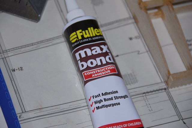

                          I found another alternative to white glue.
                          Max Bond. It holds well and have little run-out tendencies compared to white glue. I use this a lot in the building construction and its really easy to work with. It can be sanded.
                          Apply beads on area to be glued. Put the parts together then immediately separate the parts and wait 5mins. Then put them back together. Use clamps to hold them firm. After half and hour its solid already.
                            Brudder, laser cut kits are only available since the last 10 years. Remember back in the earlier days when all kits are die-cut?
                            Anyway, PVA is fuel-proof if the exhaust slime find its way into the wood. I'm not sure whether Max bond is though.

                              Thanks for the tip. I'll test it.
                              Or, unless I glass the fuse and the wings after the sheeting stage.
