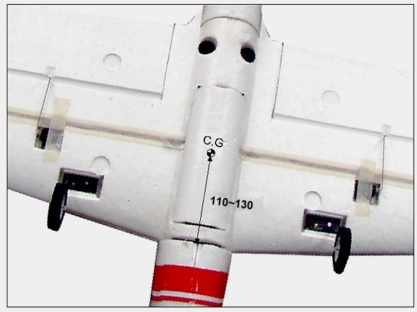

      As for the ESC,Receiver location,and lipo location, use masking tape to roughly secure them inside the fuselarge first, then check the CG as in pic 19.
      its ok to let the nose tilt a bit down(nose heavy) so in your maiden flight its safer and easier to control the plane.
      This is a very big plane, you should get say AXI 2820 brushless motor or heavy ones, you may need to move the lipo 3cell all the way to front if needed.
      Adjust the CG properly first with all your electronics,motor,mounted, its better you get someone with experience to help you with this big plane.
