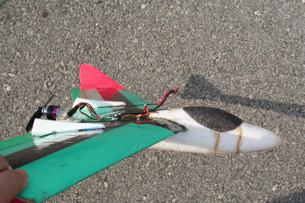

    ps: "PeterJet" is a tentative name our bro Ronang gave. Its a plane designed by Peter (Atis) we tried at Pungol Field walk siok siok...

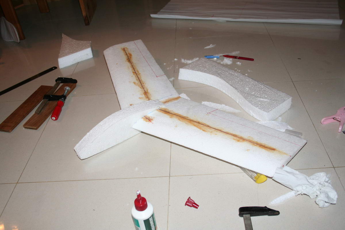

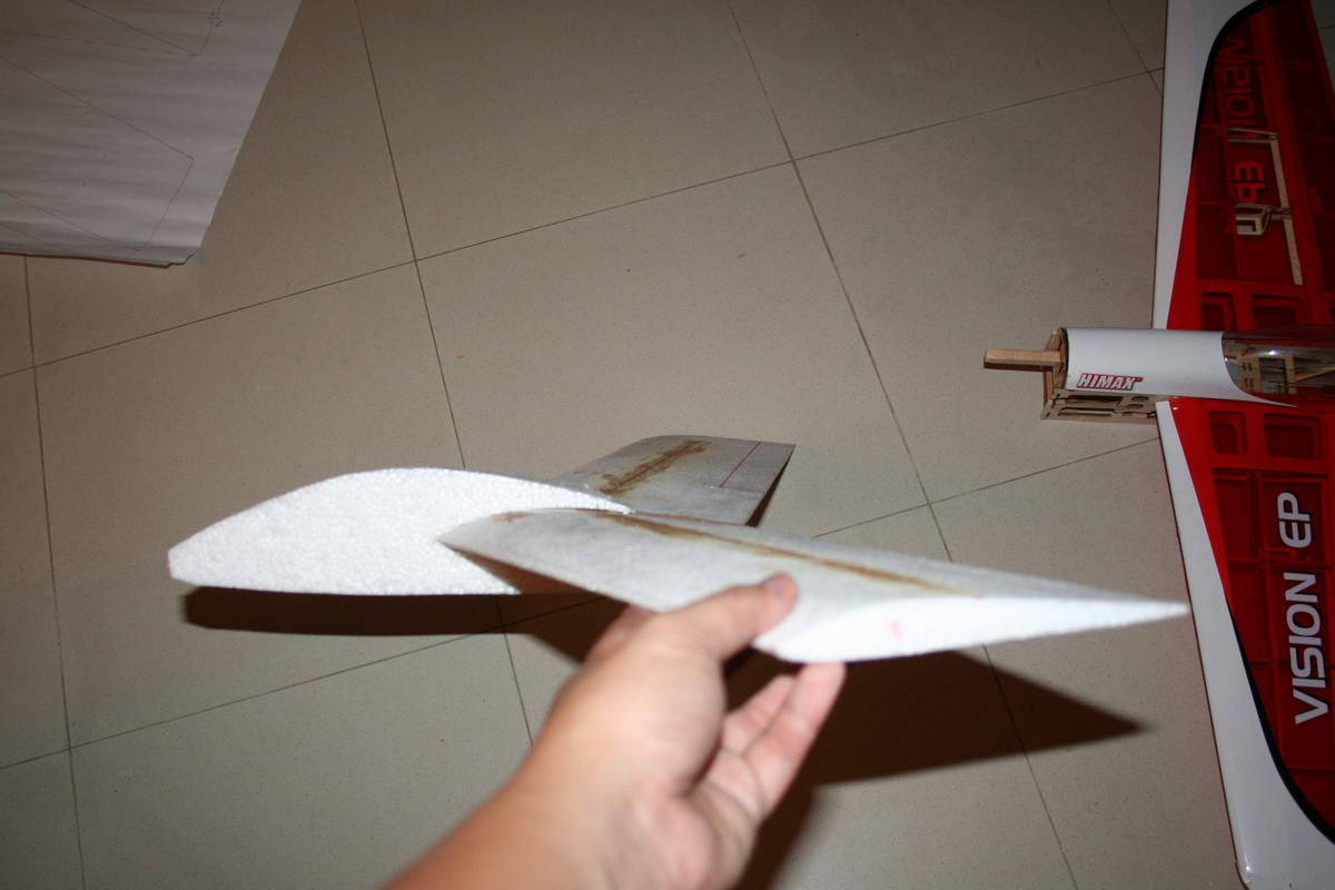

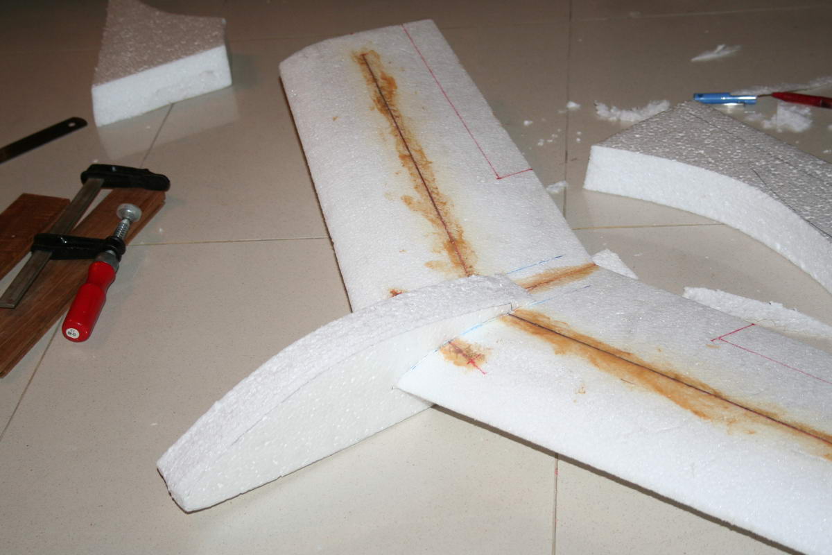

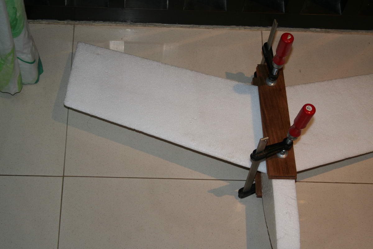

    Fuselarge cut to shape (EPP) , roughly centralize to wing,

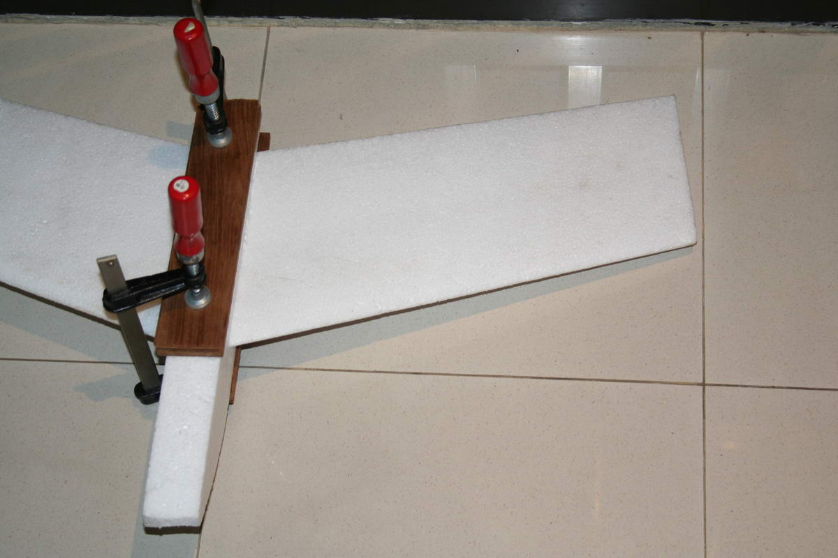

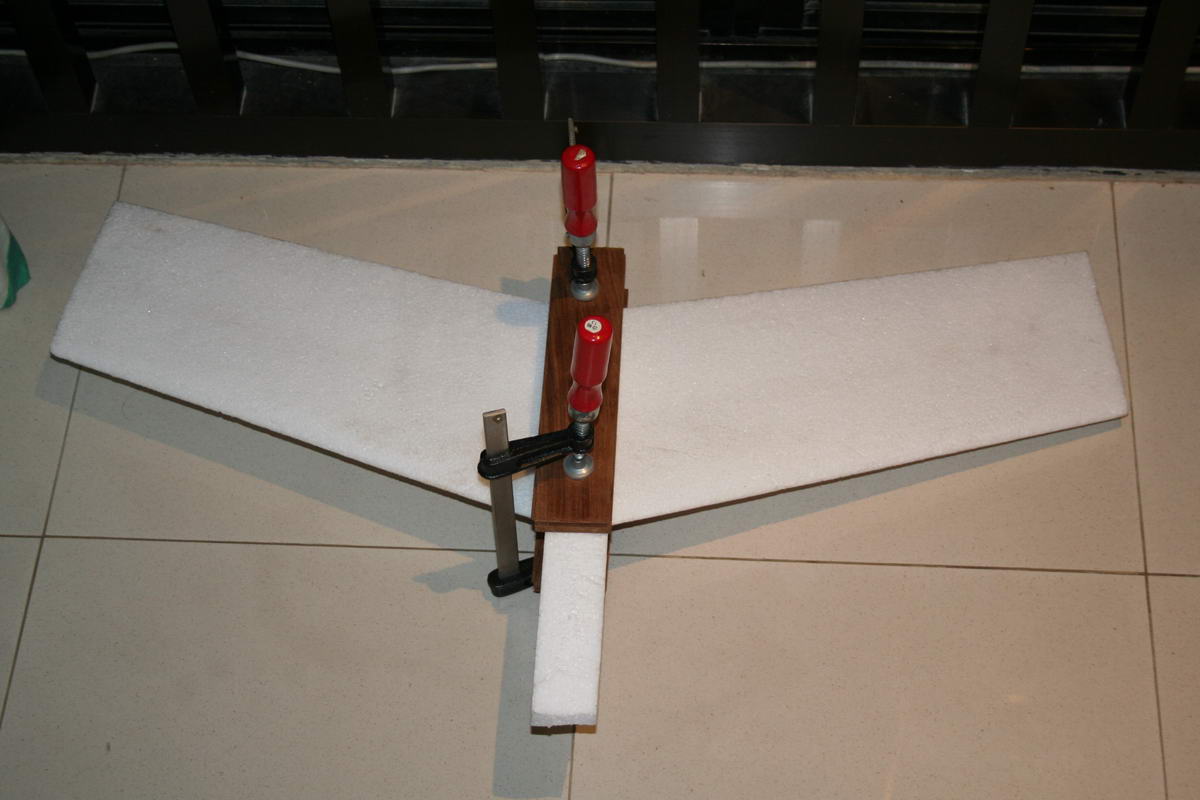

    then finally apply PVA glue (Selley's brand S$5.60) to join fuselarge to wing.
    Using left-over "pahkeh" wooden floor planks from my constructors as clamp jigs...
    Result of final built aiming to be better than the sample in green...keke...

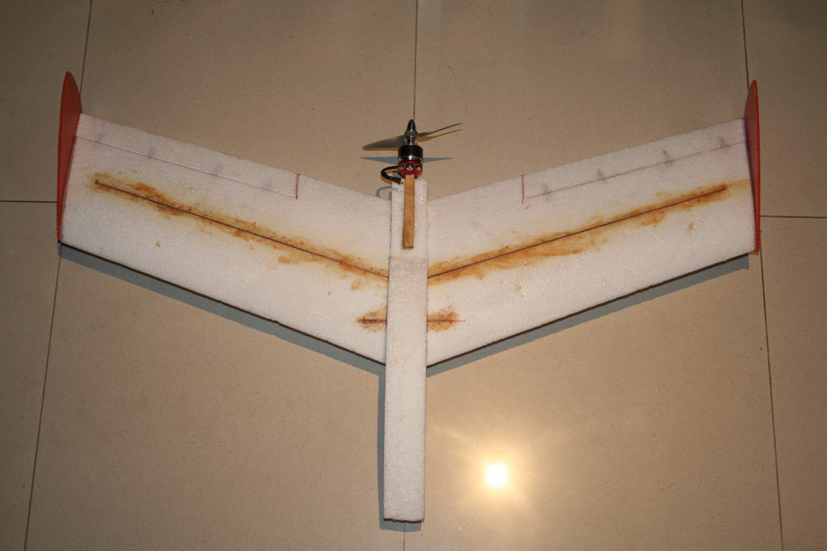

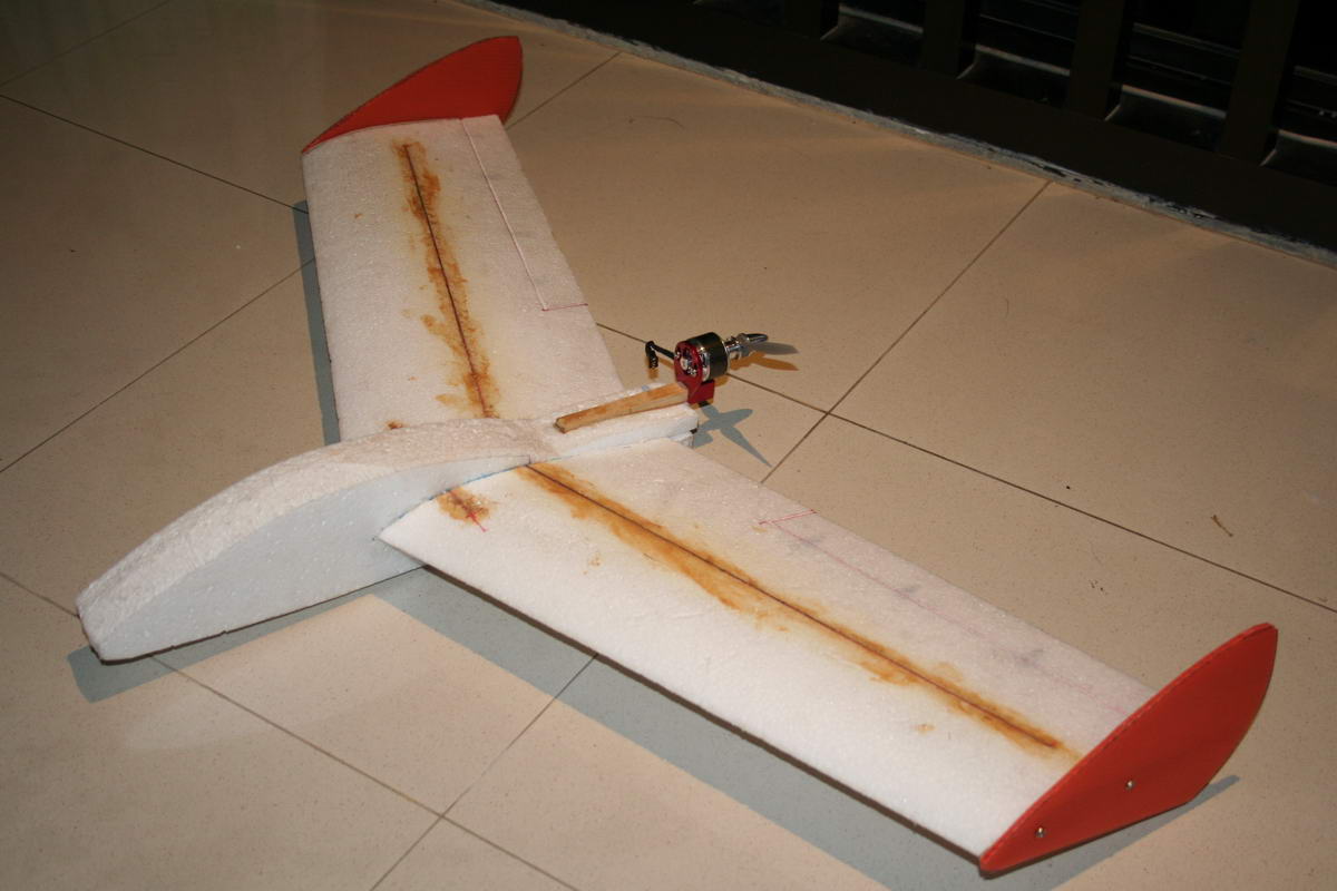

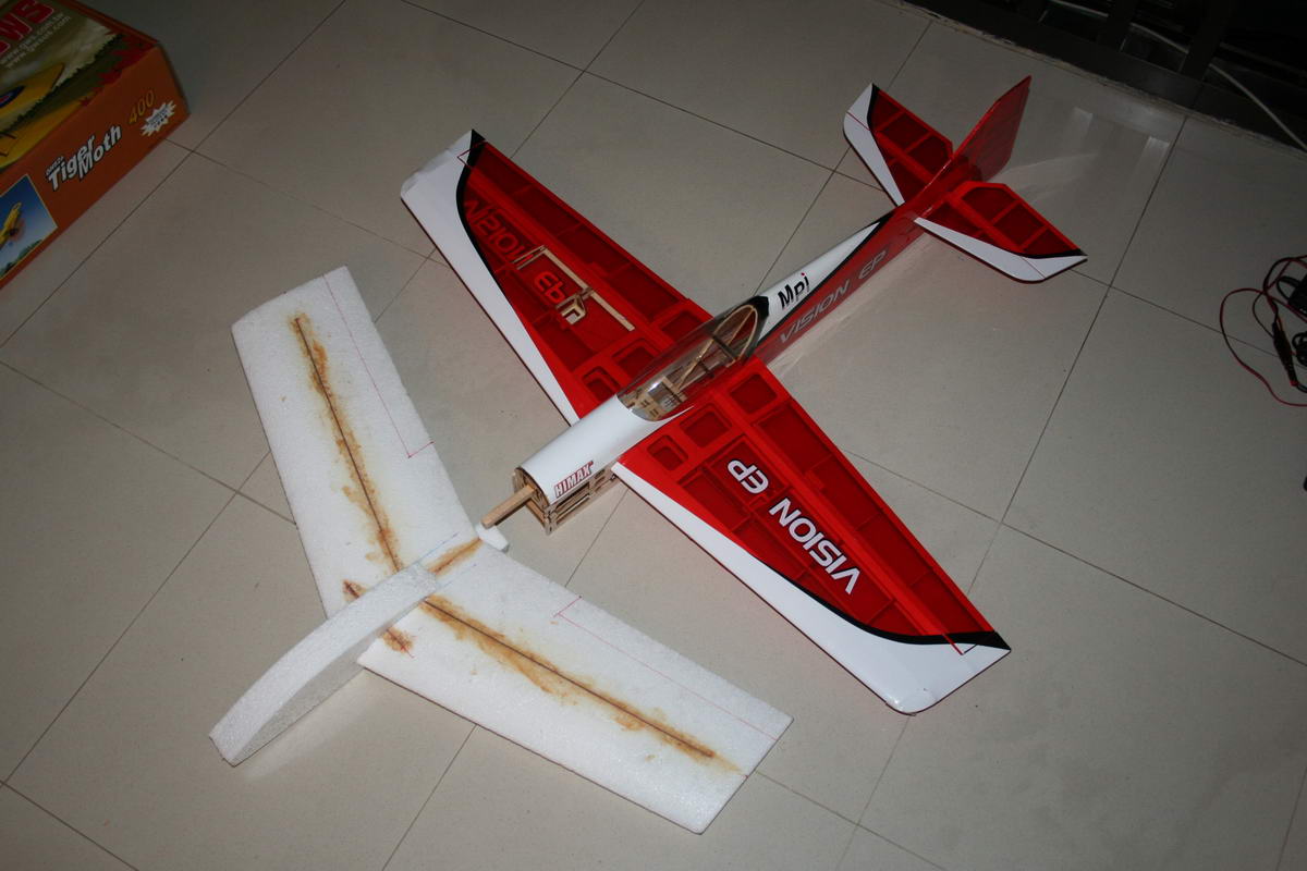

              updating building progress...
              Pulg&Fly did bit of work too...(thanks bro!)
              Hope to complete it by Friday pass to Chekgu to tune with his TX.
              If you wish to see how this "PeterJet" flies, drop by Punggol Field Walk will ya... Sat 7.30am onwards (Sunday too). most of us there.

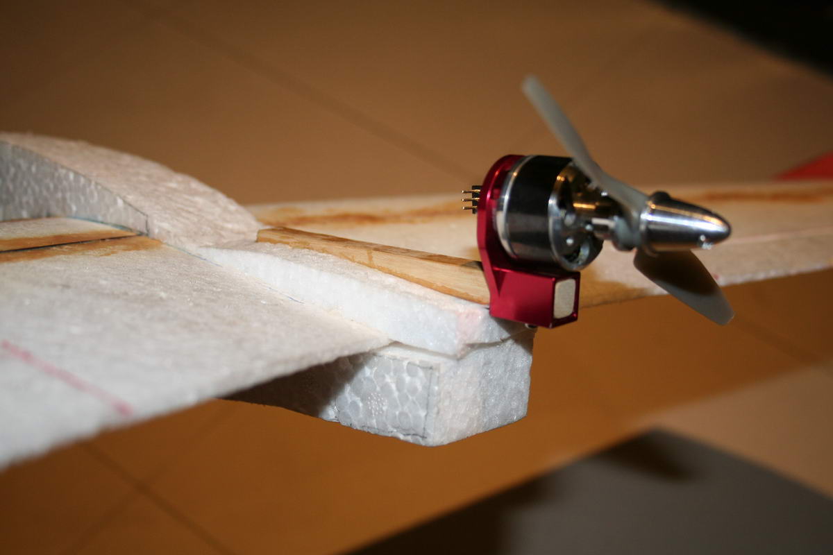

                nice motor mount
                  Nice!!, looks abit like the TT Velocity

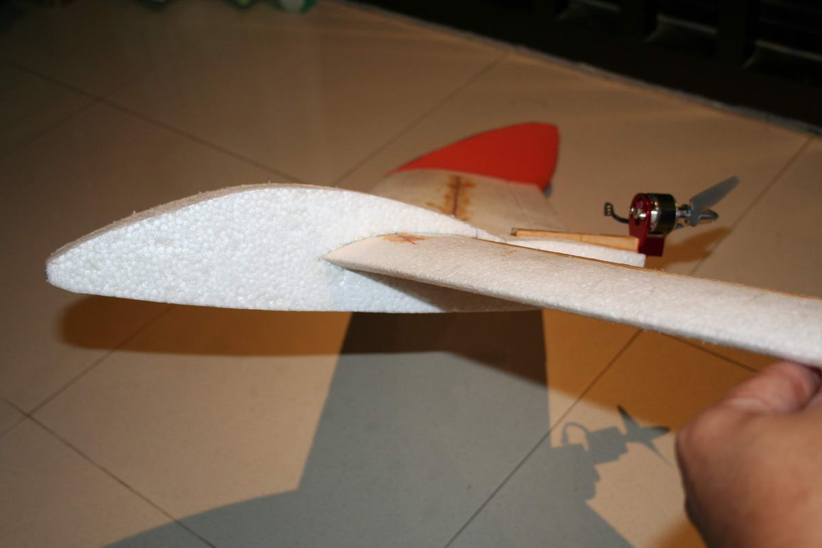

                            It flew very erratically on Saturday. The cause : not enough up thrust on the motor. Went down immediately upon take - off. Sometimes managed to fly it but when i throttled it up down it went. However, I like the way that sounds, on Sunday I inverted the mount and put the motor more along the incidence line of the wing and away it went like a bat out of h*ll. It flew fast and furious but sensitive on the elevator. and the travel on the left was more than the right. All those fixed, it flew reasonably well. Got to do a bit more trimming these few days. but in the end it was shioook. The wing flew.
