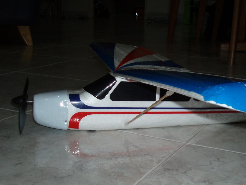

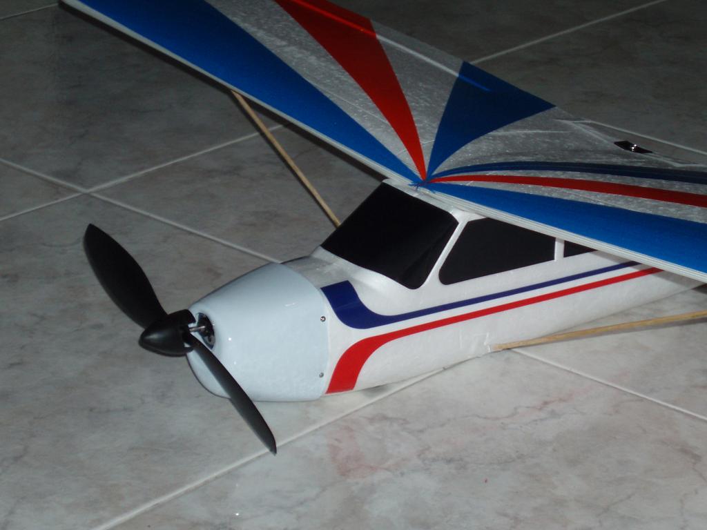

            I cut the battery compartment bigger to fit my 3 cell lipo. Make it a tight fit. And made a small strap with valcro to secure it.
              wah cool Sinkyo! would be great to see it maiden...hope Zaki's plane up soon..keke.... then I'll join you next week.
              take more pics first..keke...
