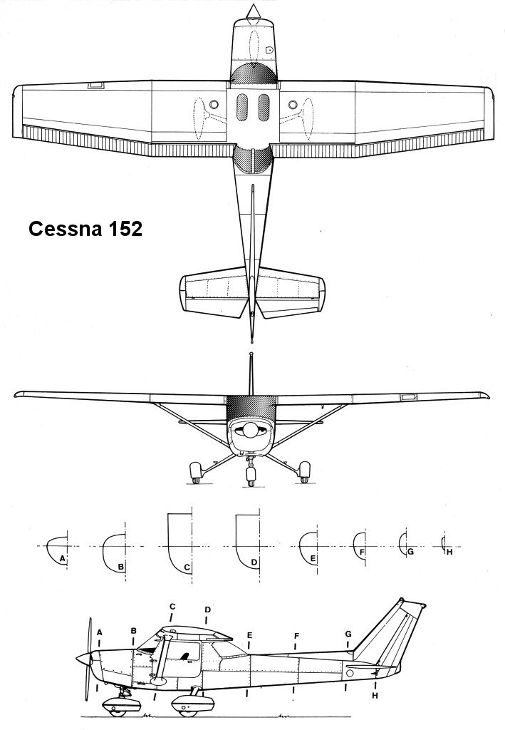

    Originally posted by benjovi View Post
    my computer isnt able to run the program i downloaded it and my computers graphic quality isnt good enough for the program but do you think if you have any spare time would you be able to create plans for a depron foam Cessna 152?
    in PDF format?
    Hi benjovi,
    You don't necessarily have to design on a computer. I started out drawing on exercise books with square lines and then scaling up the drawings on Mahjong paper. I think you should try that route first. All you need is a very long steel ruler, pencil, paper and eraser.
    If your computer can't run 3dstudioMax, I suggest using a free 3D software called Blender3D. You will have to spend a lot of time learning it though. That's why you are better off starting first with pencil and paper. That's how great airplane designers started. If you want to design a Cessna 152 model, I suggest you get as many reference images and photos on the Cessna 152 before you begin.
    I'm sorry but I can't help you draft the the design as I have too many things keeping me busy at moment.
    When I started designing and building airplanes, I had very little help, I just looked at a lot of model airplane plans, read a lot on aircraft design and aerodynamics and the rest is just trial and error. You have to start somewhere. Here's what I found on google.
