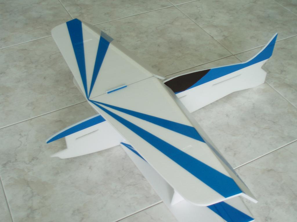

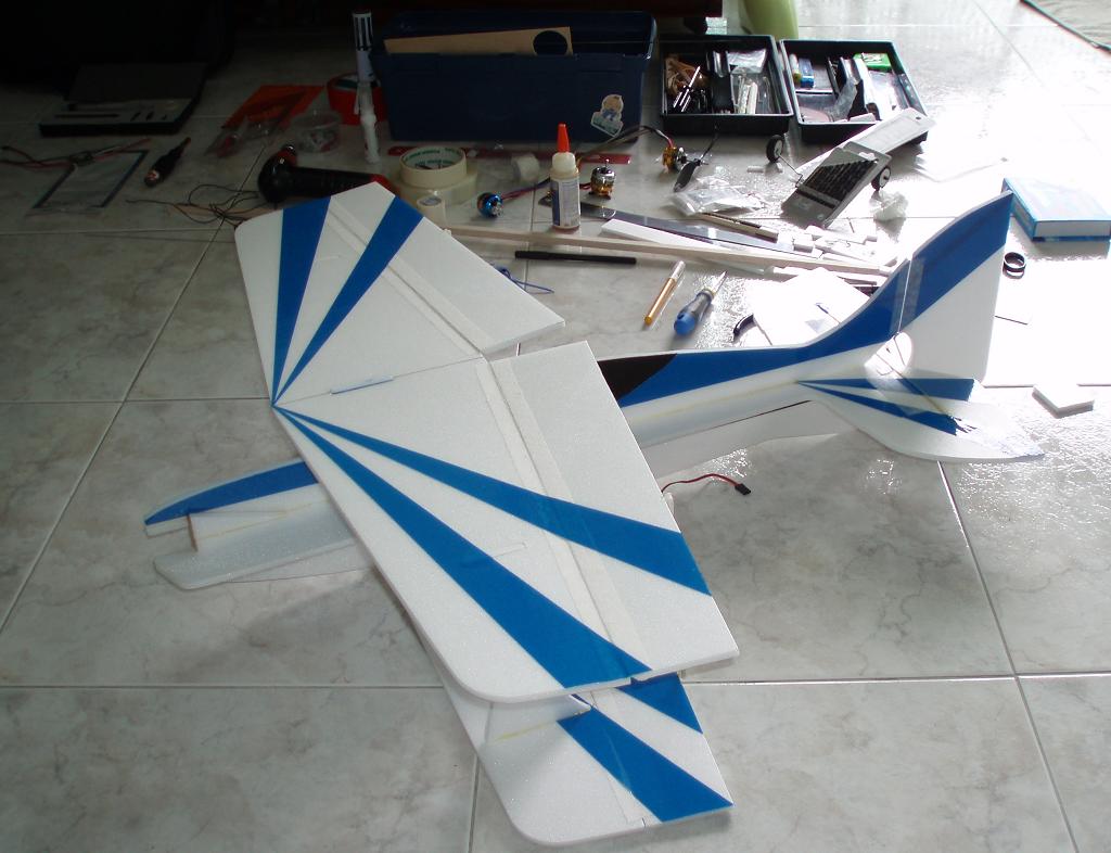

    Start making this bi-wing plane last week but forget to take picture from the beginning. This picture are almost complete, hope to finish it tonight and maiden tommorrow. John, can you help me maiden this plane? Thank you
    thats one hell nice bip. Using what power elects?prop size?
      thinking of using AXI 2212/34 and 12x6 prop. will post more after maiden
        gd luck!! more pics!!thnks
          sinkyo i'm using the same motor as you... i think 12x6 is a little too much for that motor... i used 10x4.7 and its clocking up to 9 amps at full throttle... i think max you should go is 11x 4.7 .... but if you tested it and its good please let me know

                        Total weight include 2S Lipo is 390g. Is this too heavy? Please comment?
                          what's the wingspan and chord of 1 full wing?

                            Yours, Total weight include 2S Lipo is 390g, but not to forget, you got TWO WINGS....... the answer is obvious.....keke.... yours will float like mad...
                              Thank you for your comment, new plane wingspan 29". I am keeping it light so that I can enjoy relax flying. One wing is good, two wing is better.
