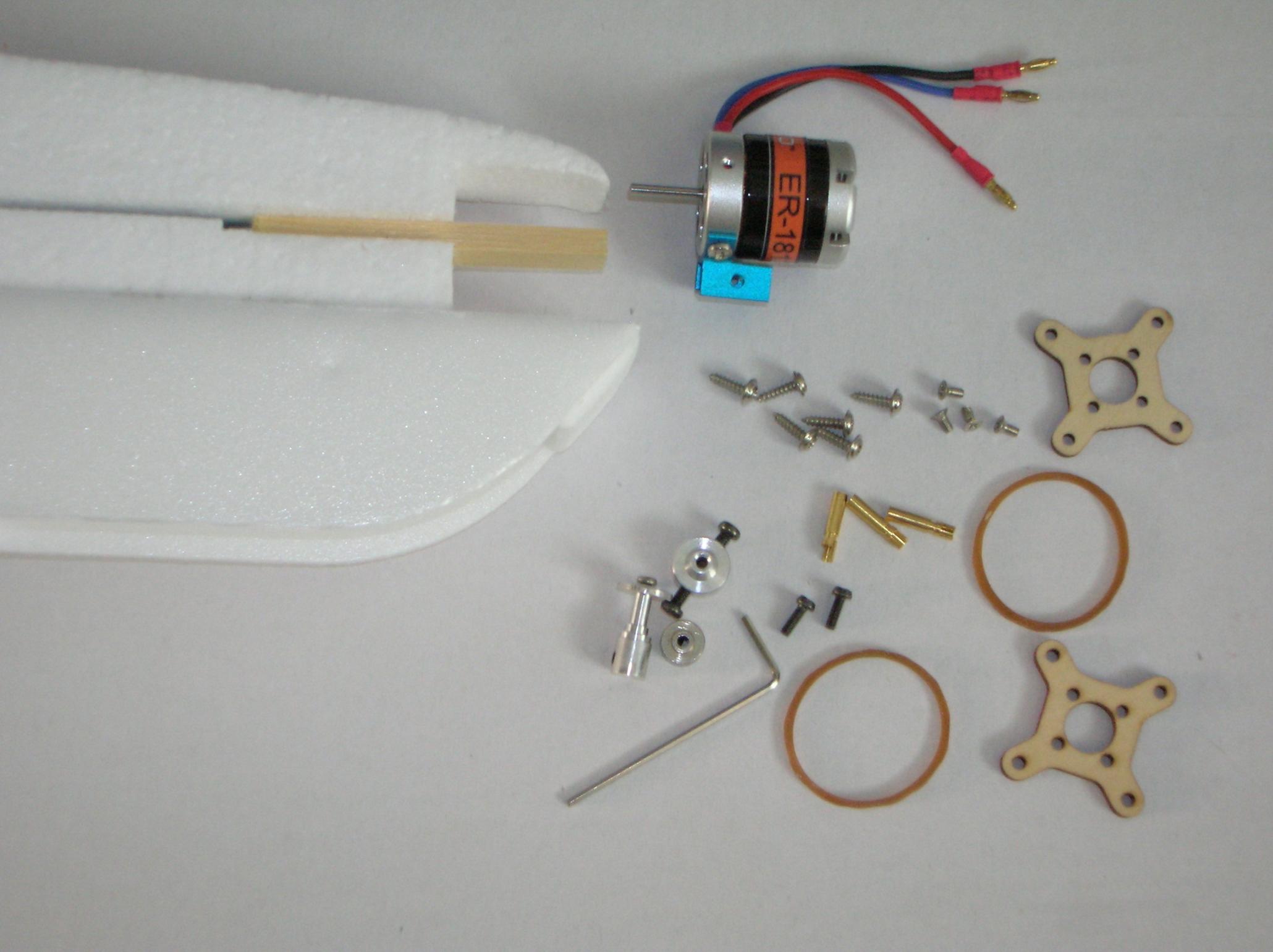

Hi, i gt a outrunner motor to mount on a 3D trainer but its my 1st time mountin it..hav nv seen how a outrunner is mounted..Can explain in steps here?..Sry to inconvenient..Thanks.. All t little parts i hav r in t pic..u can see tt t balsa stick is nt aligned wit t motor..t stick is mount in such a way tt its for a IPS motor..might need to shorten t stick..but i dun wanna error on tis project..Thnks & Hopfully tis would help others in t future..Cheers..
Mountin Outrunner..
Dude... you already have a stick mount on your BM... why do you want to use the balsa mount anyway? just screw the motor onto the stick ... btw... are you using depron or normal styrofoam ... looks pretty losely packed form the pic...

Hi..Thanks xwing & collectivepitch fr another thread on tis topic..I hav finally taken t courage to cut off alittle piece of foam fr front of t fuselage to fit in t motor onto t balsa mount..& i hav fitted in t prop adaptor & saver aft afew trials & error..Nx step im plannin to do is to solder t connectors to t ESC..Hav 2 types of connectors to look aft..One is t golden motor connectors & t battery connectors.. Hmm..tis gonna take mi 2-3 more days to complete(coz hav other errands to do too)..Thanks xwing & collectivepitch..Pic shown below is wat i hav accomplished..Shall post again aft t connectors r up.. Pls continue to advice on t little things on buildin up a plane..Thanks..Cheers!..Owns:
