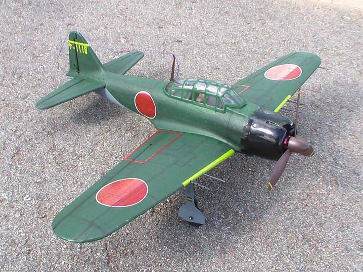

    Let's talk about the Zero since it is the first warbird produced by GWS.
    The initial design of zero is powered by a 150 size motor, so in order to have a S & L flight profile, the stabilizer was purposely make to pitch the aircraft up to hold the aircraft. But since everyone starting to use Brushless motor nowadays, which is much more powerful, so pitch up is not necessary, which mean that during the construction of the plane, the stabilizer have to pitch down by about 2~3 deg.
    The zero, despite the design fault is a very manueverable plane, comparable to ME 109 and F-4U in the same series.

      Sorry i have a bone to pick with the zero too
      I am surprised that Master Luo said that the plane used a 150 sized motor.
      With that motor and all the electornics on, its not gonna get off the ground haha...
      also based on what he said about the pitch up to have straight and lvl flight..
      i have to see this plane in flight... a zero doing a harrier haha! gee... GWS as usual giving excuses for not fixing flaws in the plane!??? whatever happened to scale?
      I am not shooting GWS for their planes. I learned to fly on them and i believe brought RC flying to many ppl. but please if it is a flaw and you dont really want to fix it, then dont talk about it.
        OOps could not edit to add to my reply...
        The recommended way to fix the GWS zero is to add a shim on the LE of the wing, to change the incidence. I am not sure how you are gonna make a pitch down on the horizontal Stab. on the Zero... looking at the construction of the tail plane area, it leaves little room to alter the angle

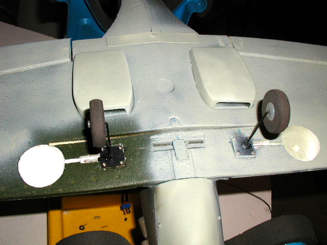

                      Hi,
                      anyone has pic/links to the above mentioned mod to the Spitfire?
                      Also, has anyone here managed to install retracts on this plane?
                      Here's some pics i found off RCG
                        oops...here are the pcis
                          Anyone?
                            hi
                            i notice the two white box like tings under the wings.. what are those.. and who can help/ accompany me to buy my 1st EP plane two weeks later.. after my term test.. finalli save up enuf and learn enuf frm here alrdy.. haha...
                            Junwei
                              The white boxes are scale details for the Spitfire - air scoops on the real plane.
