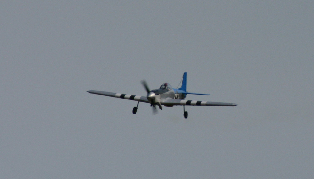

          Pix of my p51
          just learning to fly
            Hi Jephry,
            Do you have any c.g. or balancing issue on the wing itself?
            What is the flying characteristics of this plane? anything to watch out for?
            Thanks!!
              the cg is on the landing gear line
              flying character is fine except i fly it nose heavy and try land with 10% throttle
