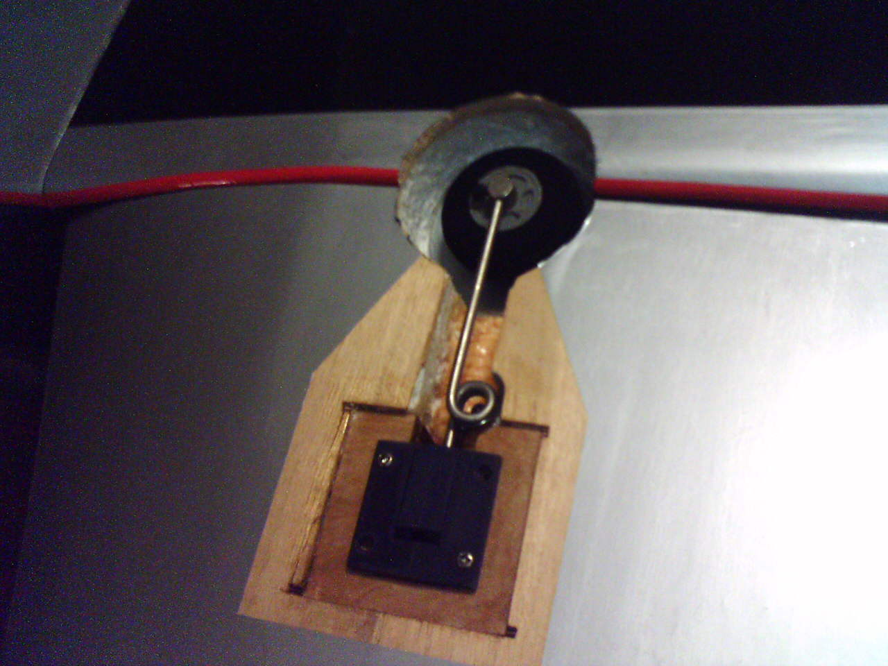

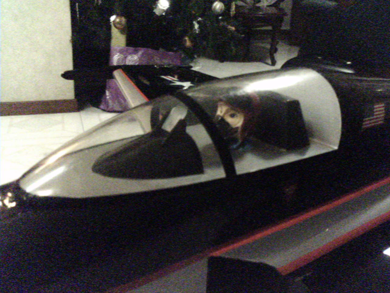

          I got one some time ago. I did some mods to make it look like the F5 with "twin" nozzles, cannons on the nose, missle rails on the wing tips and a cockpit with pilot, seat and head-up display. I am installing retracts now and a lot of modification needed to be done on the wings to accomodate it. Will post some pics of it soon.

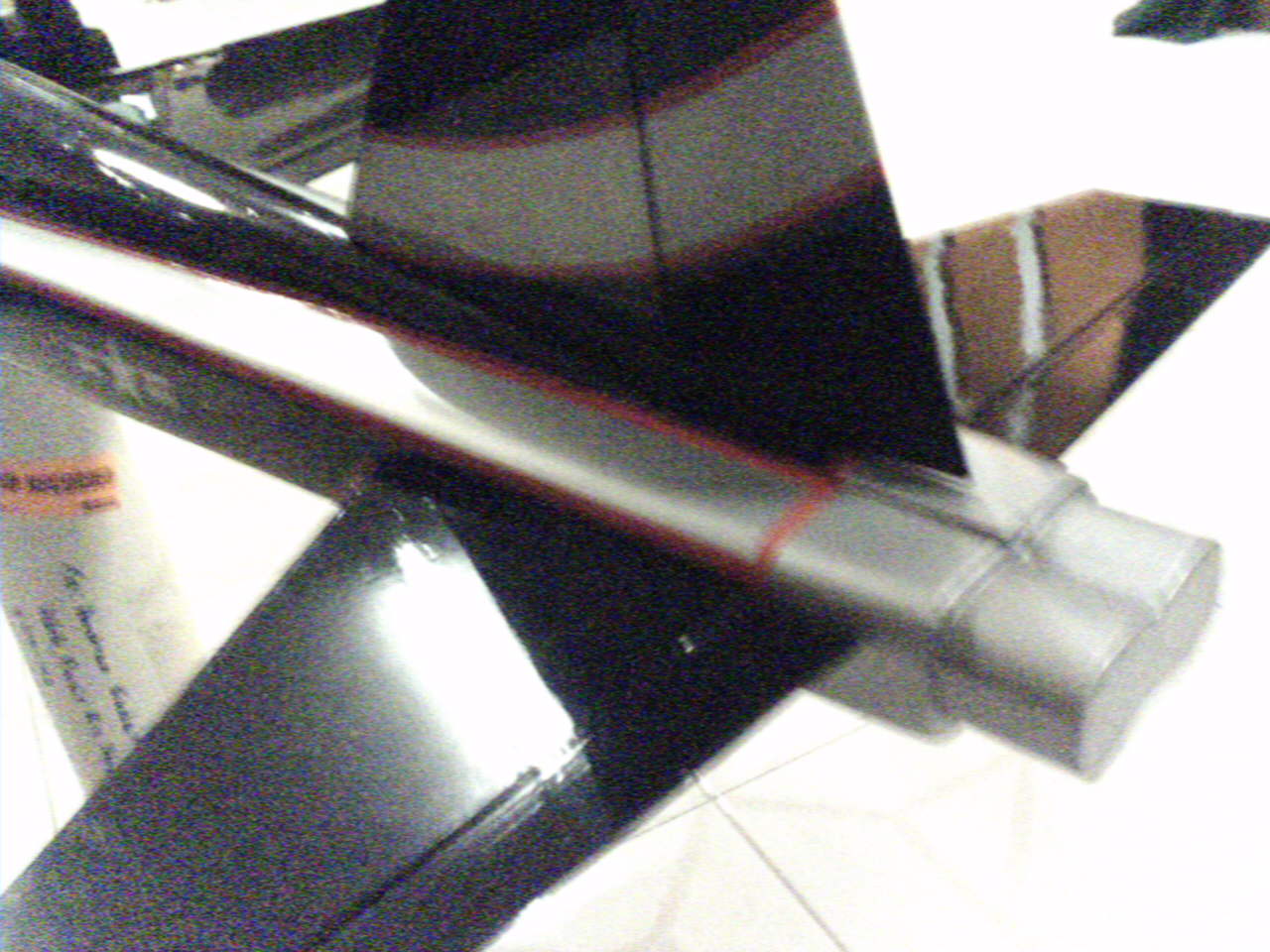

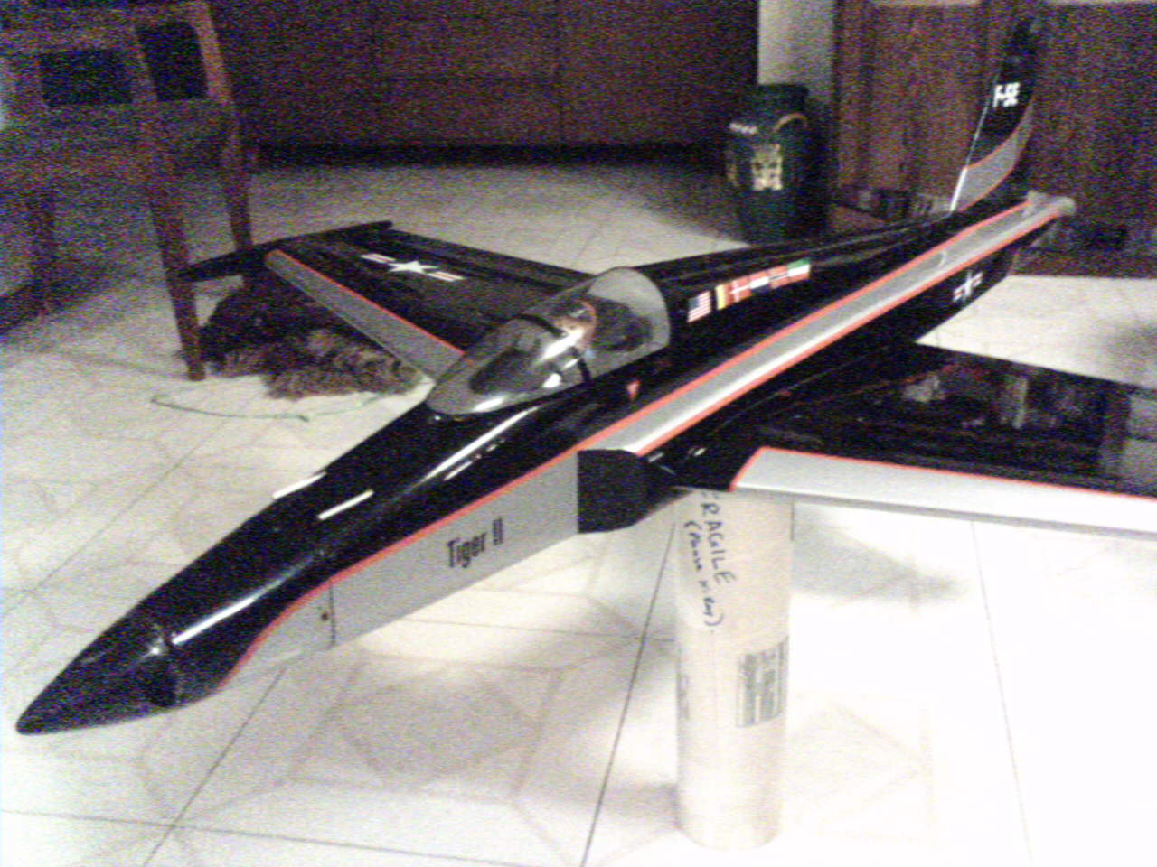

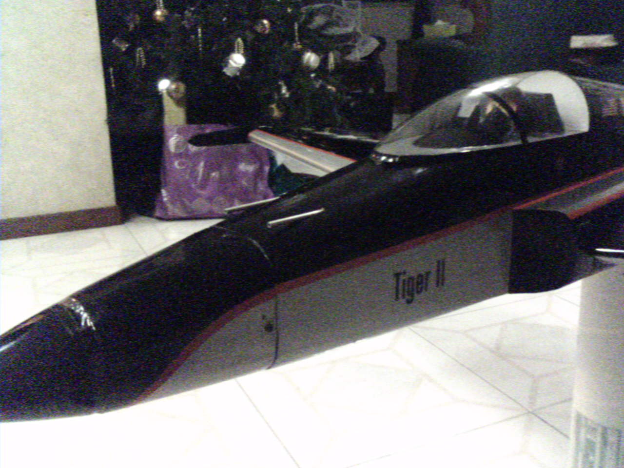

                As promised , some pics

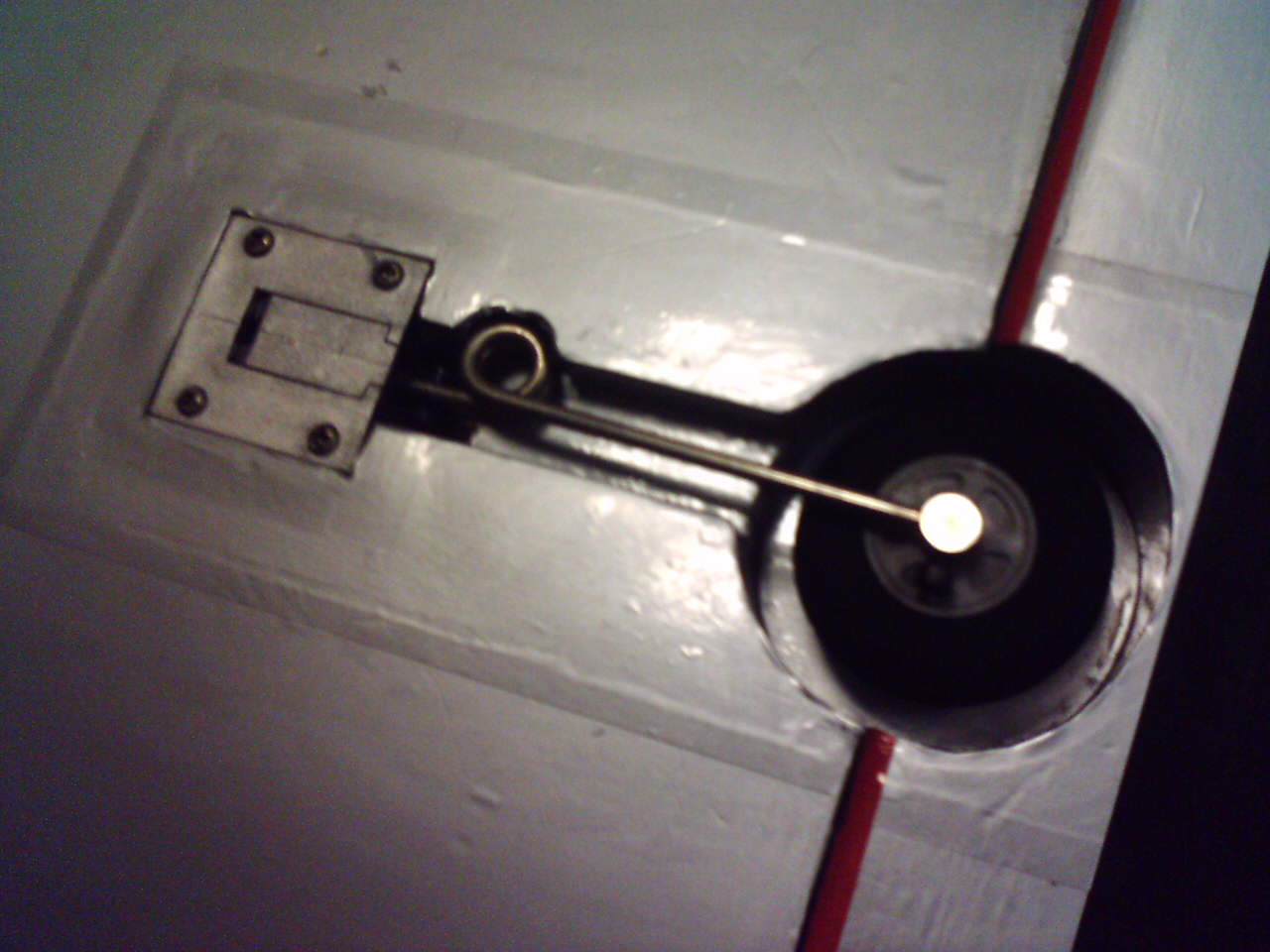

                  More pics,

                    The bird was purchased in 2001 and has had some air time with fixed undercarrage. One nice feature of this plane is that ALL linkages are internal. No ugly control horns and pushrods to be seen. The colour is black, silver and red

                        Running an OS50fx on a 11/6 prop. after the mods, she will be a little heavier with the addition of 2 retract servos and 3 machanical retracts. May need more power so will ask (my good bestest best friend) CURARE to lend me his os91
