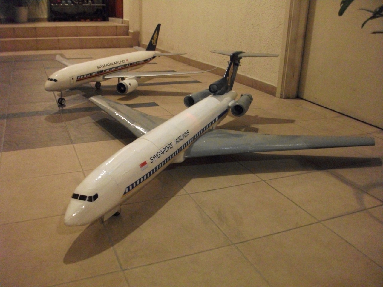

It have been almost 3 years since I last posted my scratch-build aircraft.

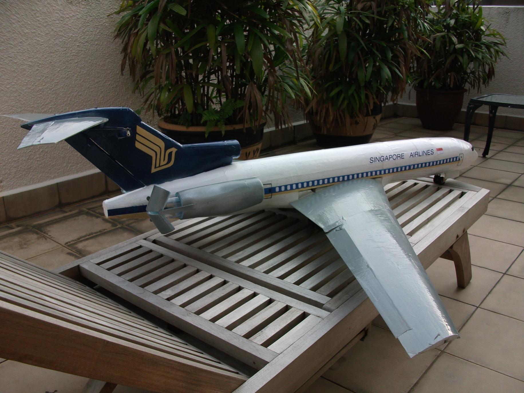

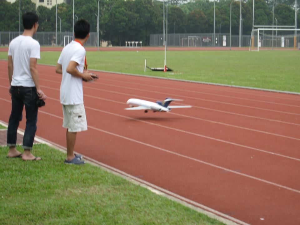

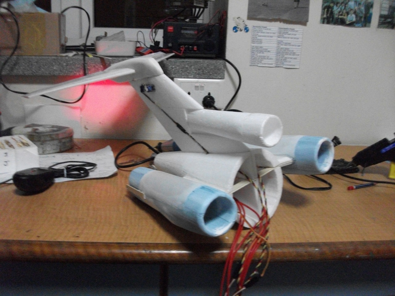

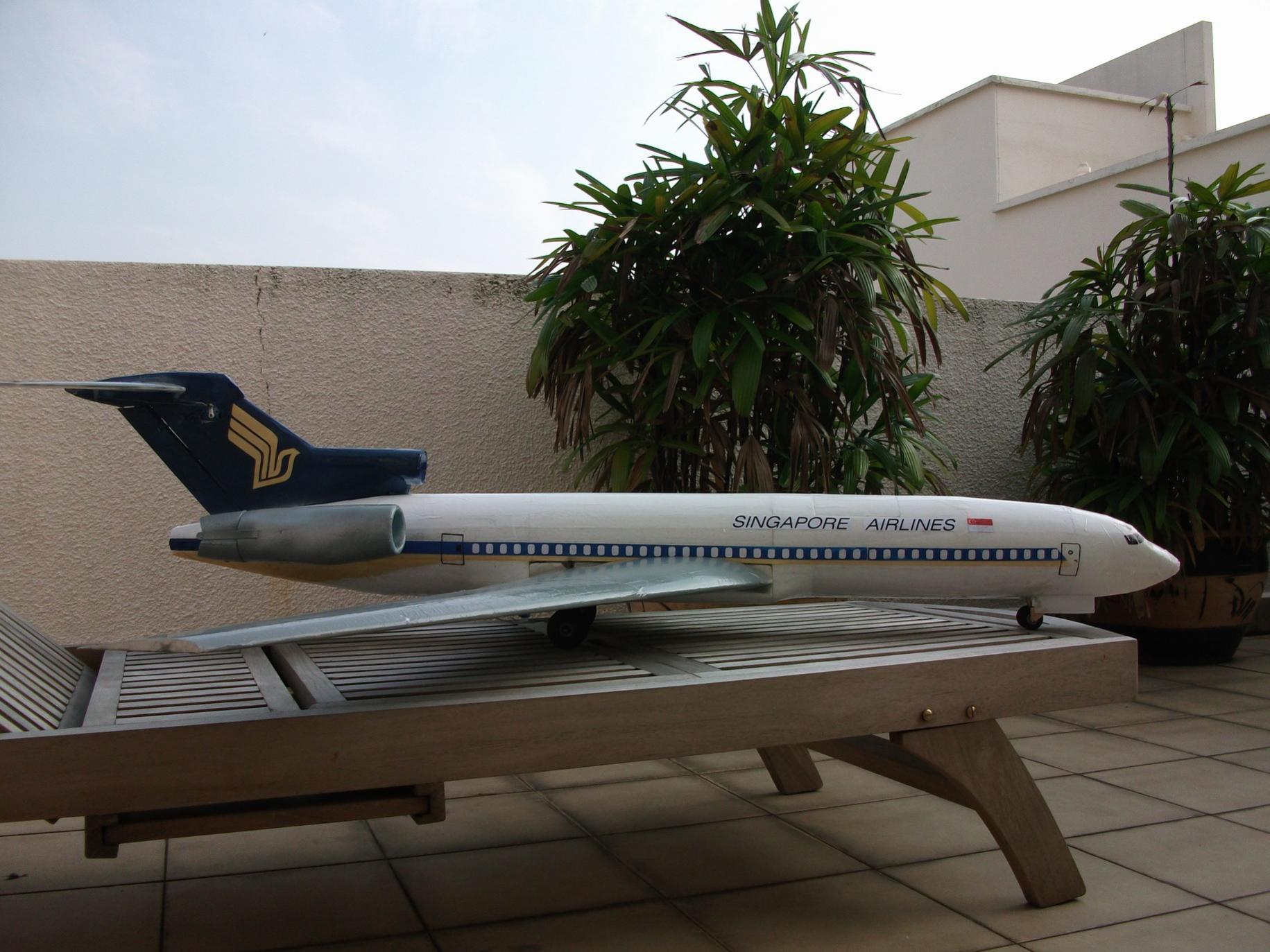

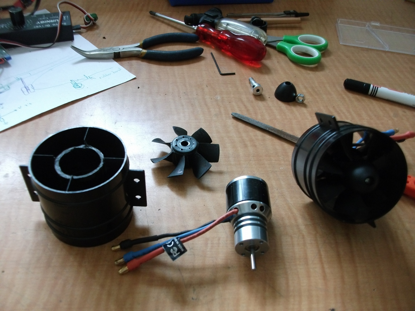

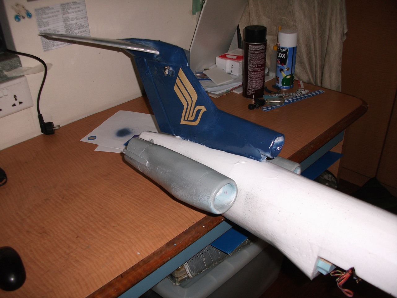

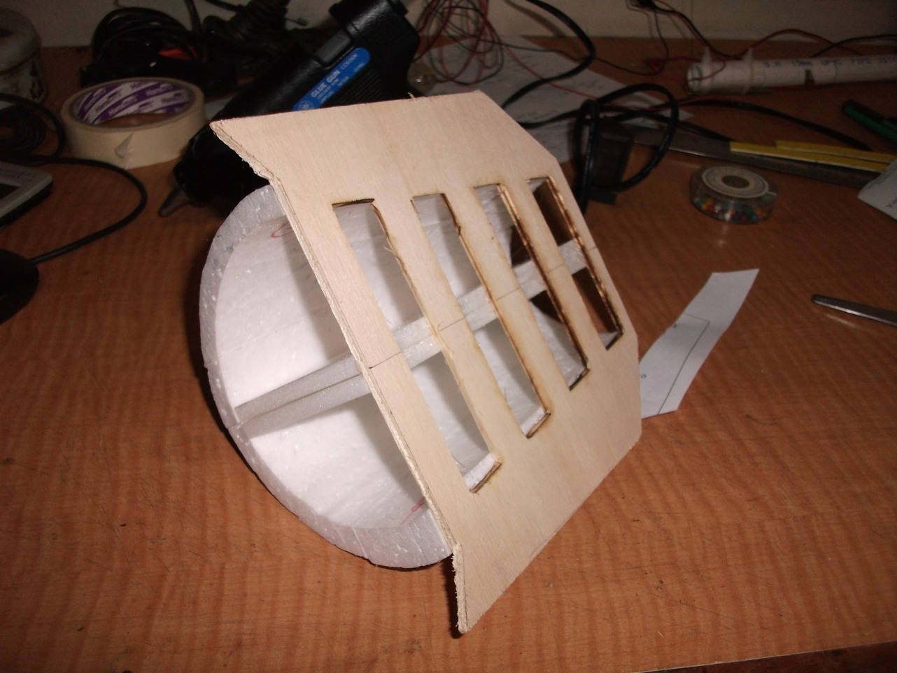

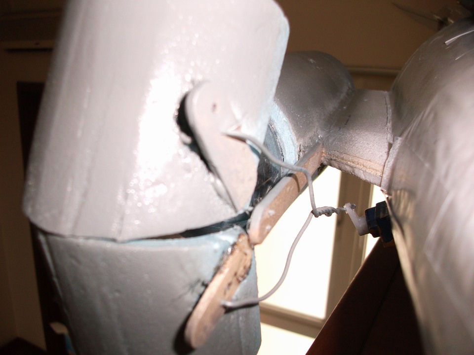

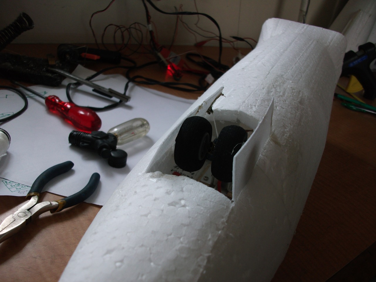

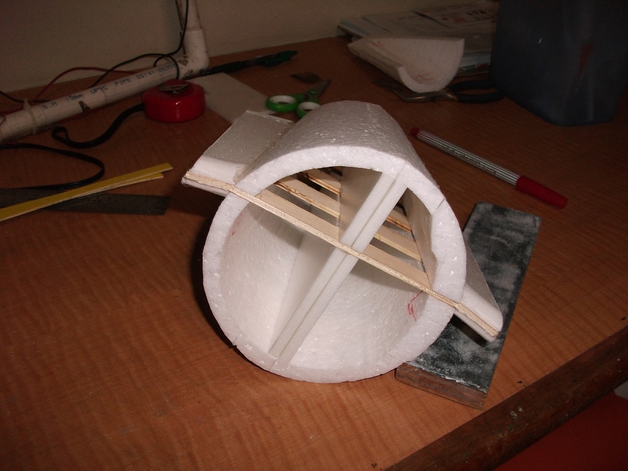

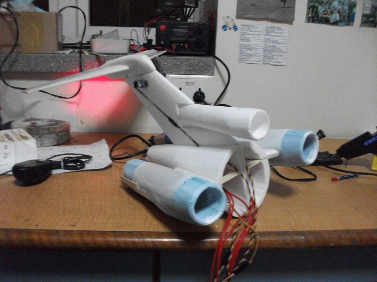

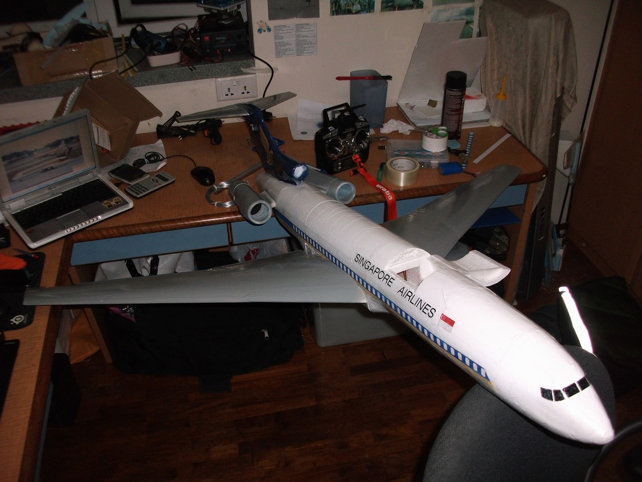

While I was still in the army,NTU Aerofest was just around the corner ,infact it was just 3 weeks after I ORD. While still busy in the army I did some planning first and placed orders on the electrical parts. When the parts arrived, I was only 1 week away from the NTU Aerofest competition! I only had 5 days to build, Monday to Friday as Saturday was the competition day itself. I knew I have to rush to come out with something elegant in flight with a "cool" factor in it. I thought of Boeing 727,something old but looks like a unique aircraft at that point of time. Painted with Singapore airline livery. With Thrust reversals and retracts! But please do not expect the finishing of the aircraft to be detailed as I was building the aircraft at a very hasty speed with minimum sleep while eating on the job!
Specification of the scratch build aircraft:
1.5meter wingspan
1.4kg AUW
500-600grams of static thrust (figures will be different in flight)
Wingloading of 17oz/sq ft
4400Mah 3s lipo
