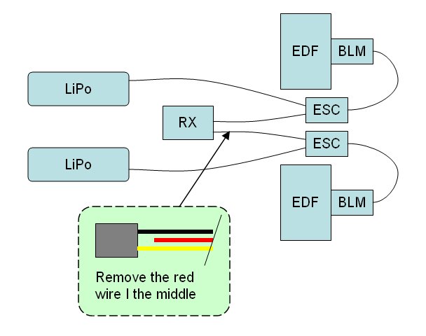

                  I've not yet purchase the BL motors as I just received the kit with the 2 x GWS stock 55mm ducted fan yesterday.
                  1. So wat u mean is I must have 2 x BL motors, 2 x ESCs & 2 x batts. Nothing more, nothing less. & they are either connected individually or in parrallel.
                  2. How do I remove the +ve pin from 1 of the ESC? Any pic or diagram to let me see how it's done? Or just cut away the black cable will do
                  See picture.
                  It’s the centre line, usually red colour. Use a needle or the tip of cutter to slowly and gently lift the tap in the connector. Than pull out the red line, flip the wire away from the connector and use insulation tape to cover the exposed metal socket of the red line. Only do this to one of the ESC, the other ESC will supply power to the RX.
                  Share the joy of flying . . .

                    ic, this is to prevent overpowering of the rx rite?
                    But can i use Y-cable to 1 lipo rather than 2 lipos? Cos of the space available n the weight
                      Not over powering the RX. This is to prevent the two ESC from killing each other as both are trying to supply power to the RX at the same time. You will see the magical orange glow follow by puff of white smoke within a second after connecting the battery.
                      Can, make sure the Lipo can take the combined amp draw from both motors.
