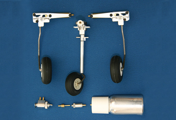

              Buddy, where did you get the micro air retracts? looks really sturdy. heavy?
                #67
                Another blur video hope can see better.
                V,
                A nice retract good for our EDF bird. More info:
                Low Profile (. 472" - 12mm when retracted)
                ● Frames 6061-T6 & Trunions 7075 aviation grade aluminium
                ● Air up, spring down
                ● Every Retract Weight : 10 g / All Parts 88 g.
                ● Suitable for EDF & Warbirds Models up to 3.5lbs
                  #68
                  This one is from MAP in Canada.
                  It has been used in HET F-20, F-4 and F-15 with great success so far.
