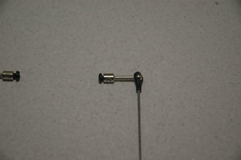

    The plane is quite scale. The only comment was the air intake should be split from the lower forward of the fuselage, besides this flaw, the plane in general is very well done. Minimum pin marks and mold release marks. The mold release marks can easily sand away. The control rods and connectors are using ball connector, which make assemble and control movement very smooth.

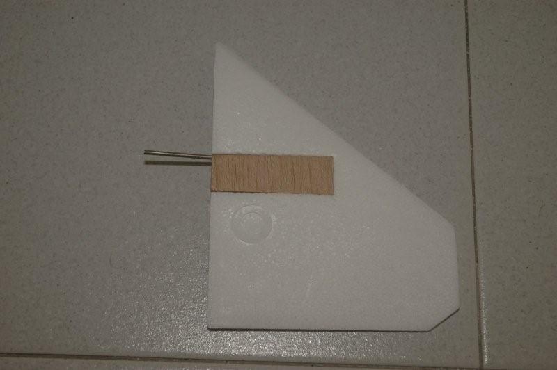

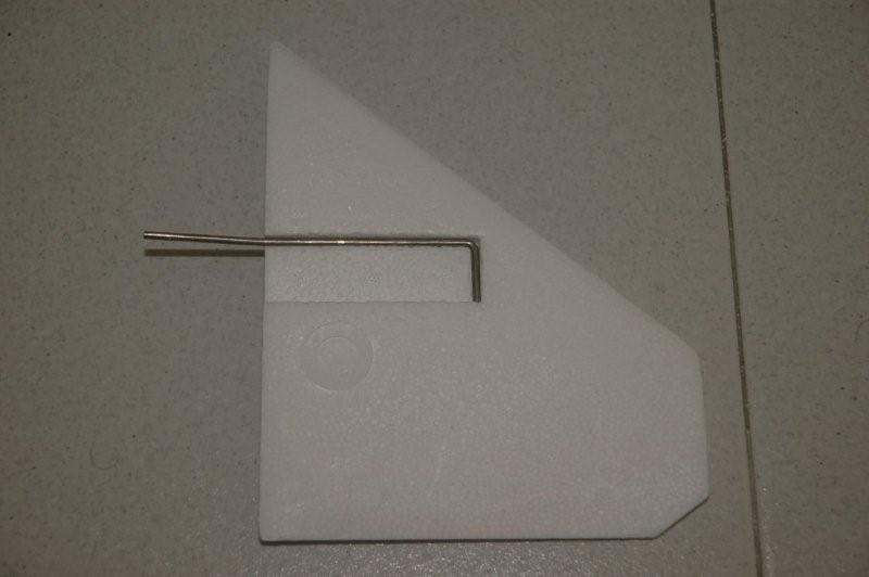

      THe stabilizer was pretty straight forward. The control rod was install into the groove and a piece of balsa is epoxied to cover it. It was later sand to shape. The control rod was pre bend to have a anhedral setting for the stabilizer...

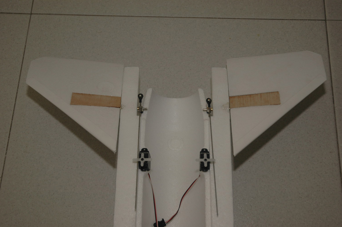

              Installation of the Elevon...

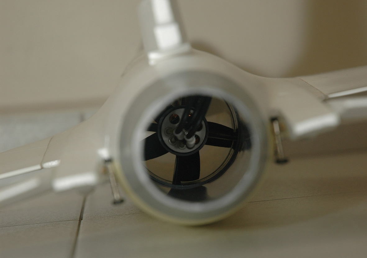

              The ducted fan and the ducting...70mm Ducted Fan with Mega 15/16/3 motor.

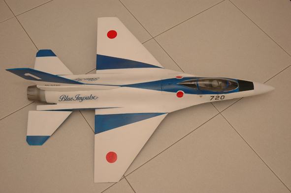

              The plane is ready for paintwork. Going for the 'Futuristic' F-2A Blue Impulse scheme...

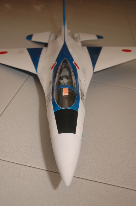

                      Finally the paint work is done...Hopefully can test flight it this week...
