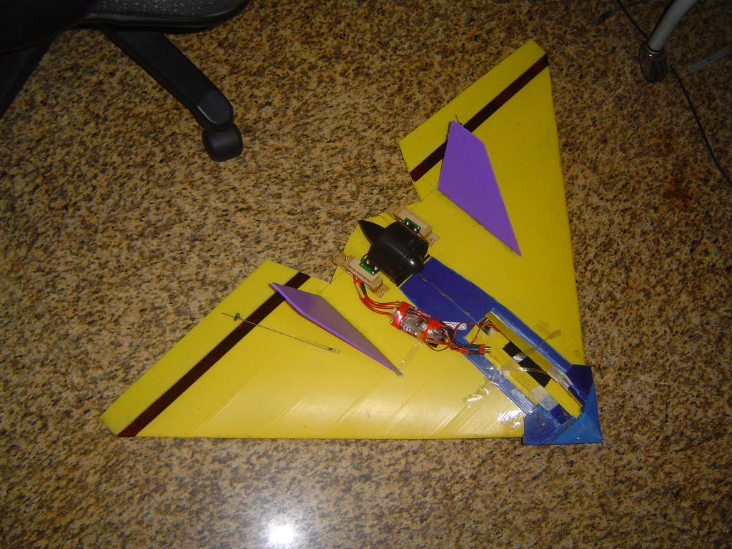

      0.9m ws EDF Mugi
      Converted one of my Mugi to a EDF.
      This one use the world model EDF with a true outrunner motor and runs on 2x1800mah 3cells in parallel and a 60amps ESC.
      Planes flew great straight and level .
      I love the sound of this EDF .
      Attached is the pictures. Sorry no video yet. ...maybe later.

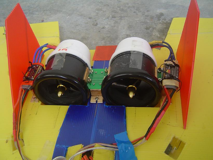

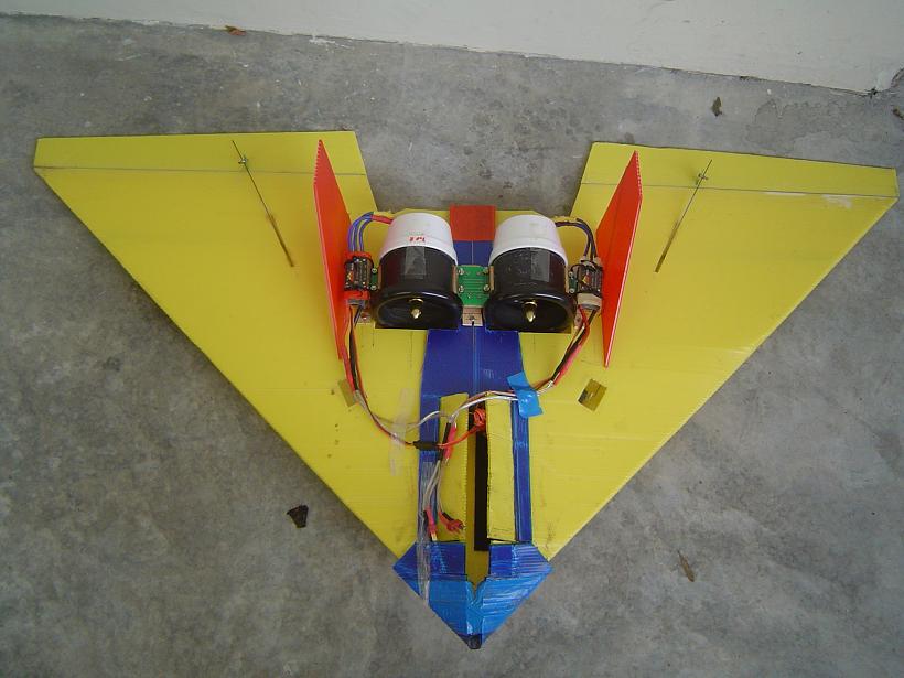

                      1m wingspan EDF twin mugi
                      I have converted the 1 metre wing span to a twin EDF using 2x70 mm EDf with experimental 3 blade. with a godd 2x2200mah 3S lipo in parallel circuit,the thrust is strong, so strong that I have to really hold tight to the Mugi at max power.
                      The re-maiden was successful.
                      The plane tracks straight and level.The plane is heavy just a tad over 1kg.
                      In spite of its hefty weight the plane handles well on belly landing.... and I went home happy.
                      The mugi is truly a inexpensive ,durable S.P.A.D..
                      I must thank the creator of the MUGI for sharing his idea and design .

                              Ha ha , I build the mugi bigger so that I can pack in more stuffs .
                              The big mugi is sucking alot of power on the twin EDF.
                              Hmm, if I am power hungry may pack in 3x 3s2200maH lipo on even bigger mugi .
                              Anyway , the big Mugi is great test bed for multi EDF setup and other EDF experiment. Maybe more next time.
