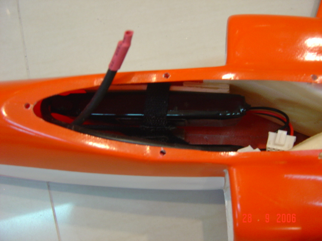

              Got the liPos mounted, c.g at 90mm from root LE. Front packs adjustable to cater for changes in c.g. due to Rx which will go into the space between the front 2 Lipo packs (not shown in photo).
              Canopy base is done as well. The base is positioned onto the fuse using the 5 short carbon rods and is held in place using rubber bands anchored to the fuse bottom.
