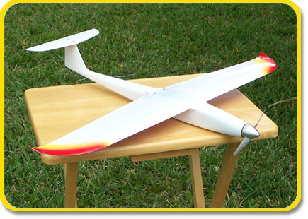

                Hi Jason,
                The Align speed glider can be very fast but you must reinforce the wing as it will flex if you pull at that speed. I reinforced both sides of the wing with CF rod & CF strip. We have tried mega 16/15/4 & warp 3T in it and the speed is very good & with a good spinner & prop it flies very quiet & you can hear the swoosh sound I can show you when we meet up. Kelvin is building a new speed glider now hehe.
                I brought in a few sokol and according to Ah Boon it flies better than VIP & has a nice whistle sound that the VIP doesn't have but the sokol is a floater so landing is very hot & more difficult than VIP. The Dynamic 400 is another good pylon, I'll be bringing in a few direct from manufacturer in a month's time

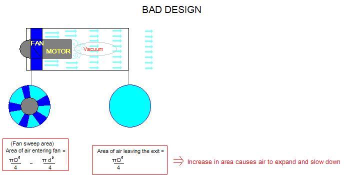

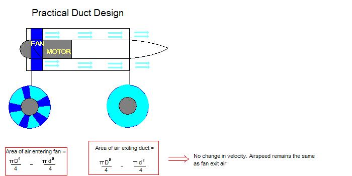

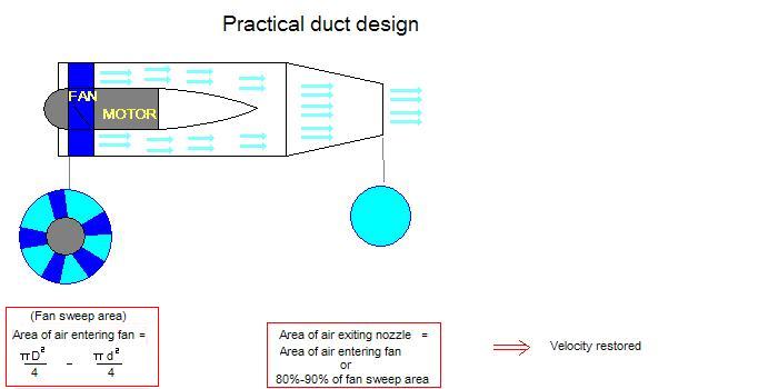

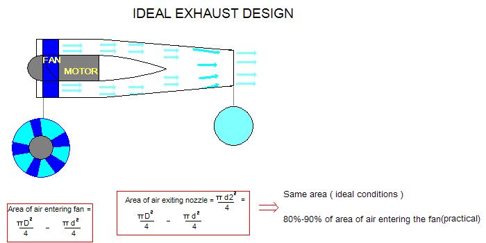

                            Guys, don't go over zealous about this thrust thing. It's just the static thrust that you are measuring which only mean how fast the plane accelerate to it's terminal velocity. Lower thrust simply means that you'll just need a bungee to accelerate the plane to it's flying speed.
                            Dynamic thrust, which is proportional to the efflux ( exhaust ) velocity is the thing that makes the planes fly. To make a plane fly, the efflux velocity must be way above; the stall speed of the plane and to overcome the total drag of the plane. Once the fan reaches it's maximum efflux velocity, it'll not accelerate anymore, and if it's not enough to overcome the total airframe drag and the plane's stall speed, it'll never get off the ground.
                            The biggest mistake of most duct fan plane design, lies with the ducting, instead of the fan. The useful work done is only happened when the efflux velocity leaves the entire length of the exhaust duct, NOT THE FAN. All calculations should start with the fan sweep area, not the total area within the fan shroud, meaning the total area within the shroud at the fan station MINUS the area occupied by the spinner hub. Afterall, the air only enters through the fan, not including the spinner and motor.
                            Now, when the accelarated air leaves the fan, and reaches the back of the motor, the area suddenly increased as the shroud outer diameter never change! The area behind the motor becomes the vacuum and the air needs to quickly occupy it, causing drop in velocity. This is what happens if you leave the exhaust duct straight all the way to the exit. This is the same theory of gasses flowing through a venturi. As volume increases, velocity decreases. In short, you may be burning 40 amps to keep the fan running at high RPM, but in fact, 10-20 amps of it are used to produce noise. YOU ARE MAKING A VERY EXPENSIVE HAIR DRYER.
                            Using diameter and angle is just a very lay man rule of the thumb. In Bernoulli's theorem, we are assuming fluids ( including gasses ) are incompressible in subsonic speed, and thus, the air which left the fan must be kept as the same area from the fan to all the way to the exit, in order to keep the velocity constant. However, in practical, some losses will be incurred and thus, most designers will reduce the exit nozzle area at 80%-90% of the fan sweep area, especially for long exhaust ducts.
                            I hope you guys understand what I've said so far. OK. Ideally, the duct size should transit smoothly from the fan area all the way to the exit, paying attention to the 'area rule', that is if you were to section anywhere in the middle, the area of the section should be the same as the fan sweep area. As such, at no time the air inside the duct will have to expand or being compressed, which leads to changing in velocities and disrupting the airflow. A compromised way is to have a straight duct all the way till just before the nozzle cone, which will have the exit area reduced to achieve the above mentioned area.
                            The next issue lies on the air which passes behind the motor. If there is no fairing cone, the efflux air will form turbulence and changes in velocity and direction. For best efficiency, the air should travel throughthe duct as straight as as possible so that the reaction will be impinged in a single direction, producing maximum thrust. The same reason as you have to punch somebody straight in the face to inflict maximum damage. If you punch his face at an angle, you'll unlikely to cause as much damage.
                            The lip of the inlet is also important, which should be kept rounded in order not the disrupt the airflow. For best results, for single fan with split intake, the air on both intake should never meet until it reaches the fan. The spinner may have to be removed and replaced by the fixed fairing for smooth airflow transition.
                            Hope these help in same basic understanding but not burn you out.
                            Note that I did not use terms like turbulent and laminar airflow in this case as they have totally different meanings in terms of fluid dynamics. These terms are usually used to describe boundary airflow near the surface.
                              These are some illustrations on exhaust duct design.
