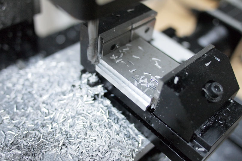

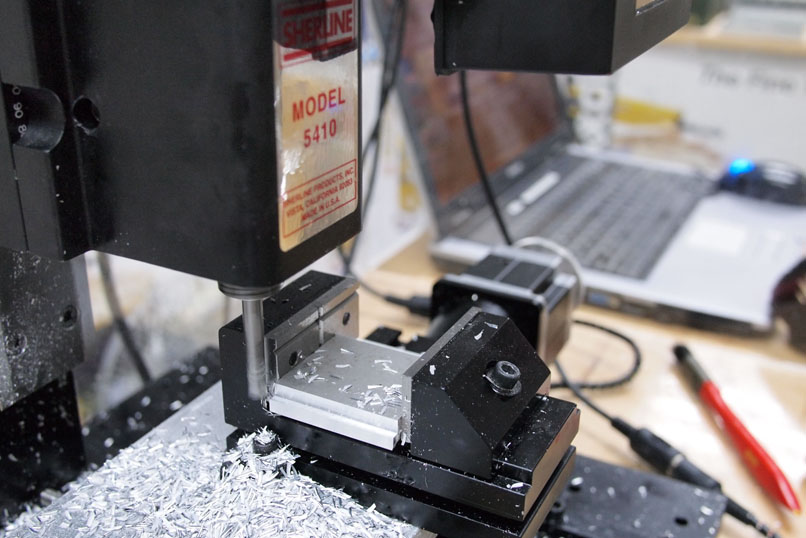

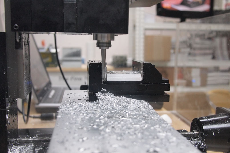

    While doing a project for JYHELI, we tried to push the Sherline machine to the max and see how thick cut it can take http://www.daddyhobby.com/forum/showthread.php?t=55511
    We managed 4mm / pass on Aluminium 6061 using a dia.6mm carbide endmill

    Good stuff, Mike! I never have the guts to go beyond 0.5mm. But I guess at 60mm/min, it shouldn't kill anything.
    So far only tried 3mm per pass on plywood

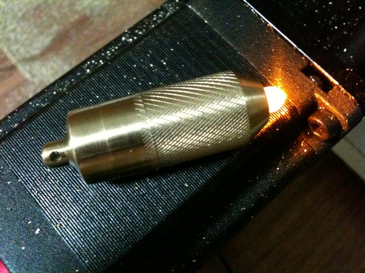

      OT: Brass Torch
      Show off a little but its an OT.
      My 1st brass torch and die-holder for the tailstock made on the lathe. <br> <br>
        great job.

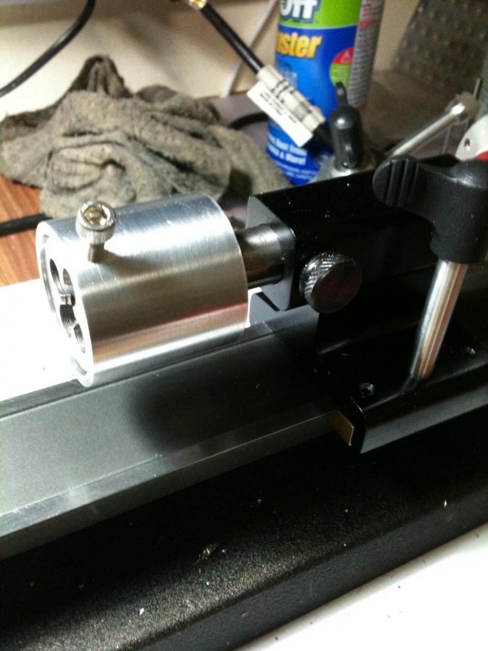

                  Managed to turn down the shank of the dovetail cutter to slightly less than 10mm. The shank is HSS. Was using HSS bit to cut. After 2 passes, it won't cut anymore. Changed to carbide insert tool. It now fits the ER16 collet nicely :-)
