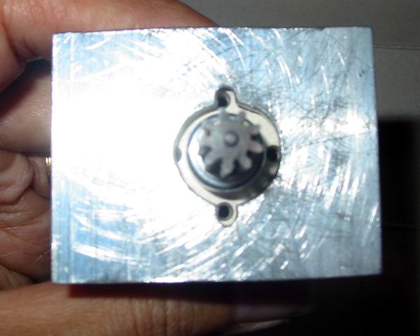

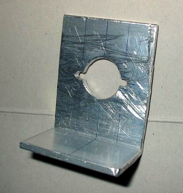

      ugly diy
      this is what i done... <br> <br>
        Nice DIY.

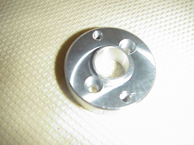

            Hi,
            Still looking for some kind souls out there to help me machine one. They have it selling in europe.
            Willing to pay for it. Thks. <br> <br>

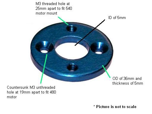

              Hi,
              I have a detailed specs of the adapter plate that I want. <br> <br>
                Hi, drop me a pm for further discussion. Thanks!

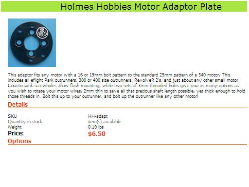

                  Just made a purchase from this site. Will wait for it to arrive and post the full specs.
                  http://www.holmeshobbies.com/product...&cat=19&page=1 <br> <br>
