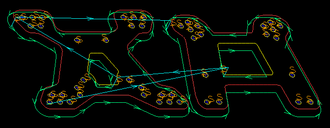

    I hand-milled some aluminum shock towers for the car but because they were done by hand they weren't the prettiest so decided to try something a bit more "factory" looking.
    Here's the pic from my CAM program...
    If it rains tomorrow I'll try cutting these out...

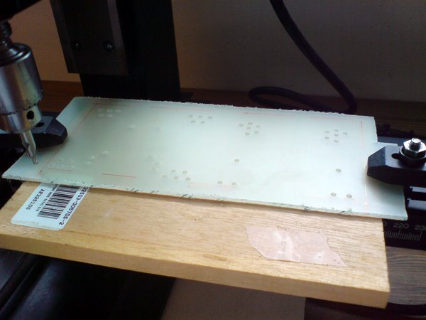

      As expected I loaded all my gear into the car to head to FW when it started to rain...
      so ended up machining the towers... nice to have something to do when it rains like it's raining nowadays.
      first program... holes center drilled.

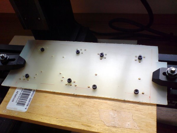

      second run... holes enlarged to 3mm, then screws attached.

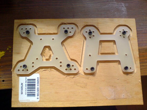

      final run... milling the inside cutouts and external shape.

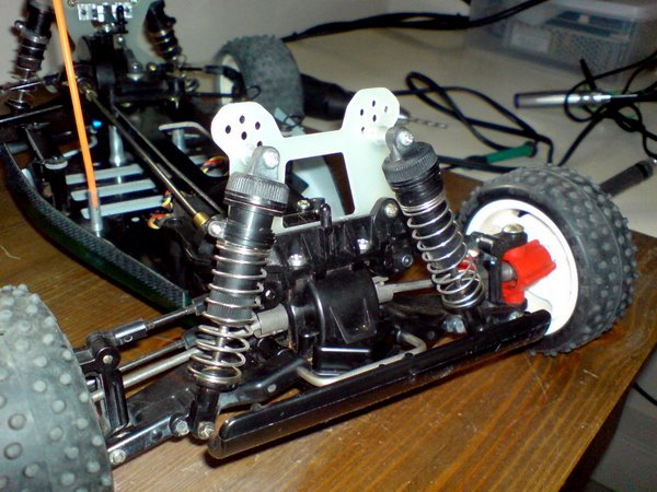

      front tower installed in car.

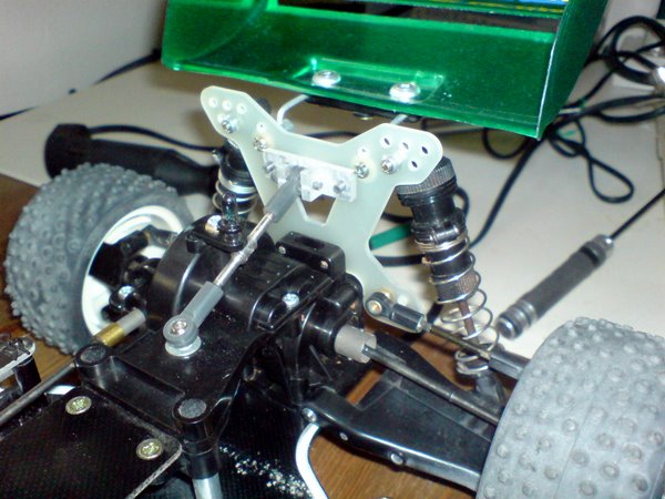

      rear tower installed in car.
        are those self tapping cap screws? If so where did you get them from? If no, how is it securing the g10 to the wood below?
          dam cool
          I don remember there are any Allen key self taping screw. I used different size philips head taping screw .. got it like 30 pcs $1.50 ... i bought quite a bit.
          BC just wondering whats below the G10? It seems to be "raised"
          Nice work bro.
            I have seen allen head self tapping screws before but I don't think they are widely available. Anyway, these are not self tapping screws. Just normal machine screws. 3mm screws threaded into 2.5mm holes. When I first tried this mounting method I never thought it would work but it did so I've been using this method for all my plate work so far without problems.
            HZM - you're right eh? looks like the G10 is raised but actually it's not. so strange.
            I have a vid of the cutting but it's in 3GP format, tried posting but it said format not supported.
              Yo BC. how deep you went beneath the G10? it will looks "emboss" to me
                ya... went a little deeper. Should be about 1.5-2mm. Overt was telling me G10 can kill the mill faster so I cut a bit deeper to use a different part of the end mill to do the cutting. BTW, I cut the shape in 1 pass. No problems whatsoever.

                        The mill seemed to handled the cutting without problems. For Alu I also used 0.5mm per pass.
                        Funny thing is for the stuff I used to do by hand I would actually mill through like 4-5mm at a go... but go VERY slow. then leave about 0.5mm to clean up the edge for a nice finish. I hated going through the same pass over and over again...

                            From the looks of your toolpath ... What endmill bit are you using? You are not drilling the holes right, more like pocketing or contouring?
                              He should be drilling See the pic above, he got the center drill on the chuck
