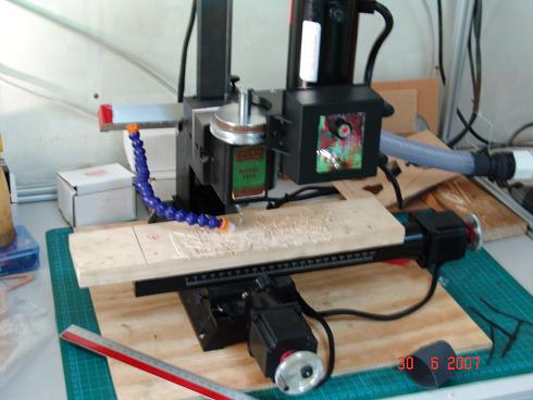

    I updated my site with the vacuum mod. This will keep those irritating composite dusts away from me <br> <br>
    i was also thinking of this idea, does it work well?
    do you add additional filter before the vacuum , e.g metal mesh ?

      nope. I will still be hunting for a loc-line with a bigger diameter.

        hmmm.... the lic loc concept is good in a sense that it allows one to tweak the tube to the position you want. I am wondering if it would be better if a flexible tube of say 3cm diameter hook onto the spindle - reason being the spindle will move up and down depending of the height of parts its milling. Just my thought.
        Anyway, great mod
        Mike
          so if you cut 12mm worth of material, the tube will follow down?
            Anyway, great mod
            Mike
            U should be able to find such flexible tube at SLT, microphone stand. During my sec sch technical project, I got one for $20 for a flexible lamp. That was in 1993.

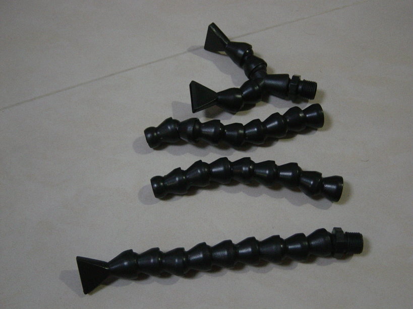

                          Here r my brand new tubes.
                          Diameter is 15mm <br> <br>
