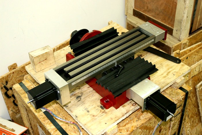

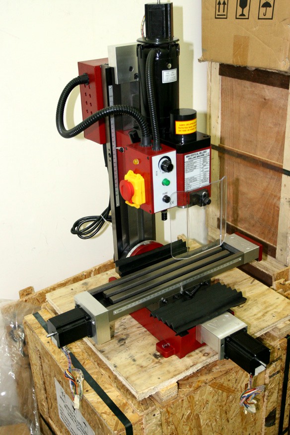

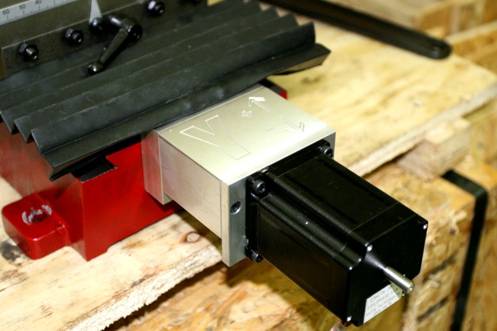

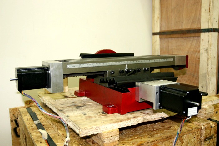

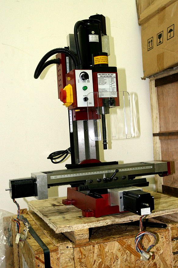

          I am back with some progress

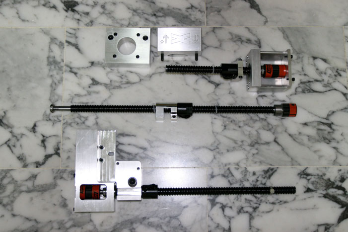

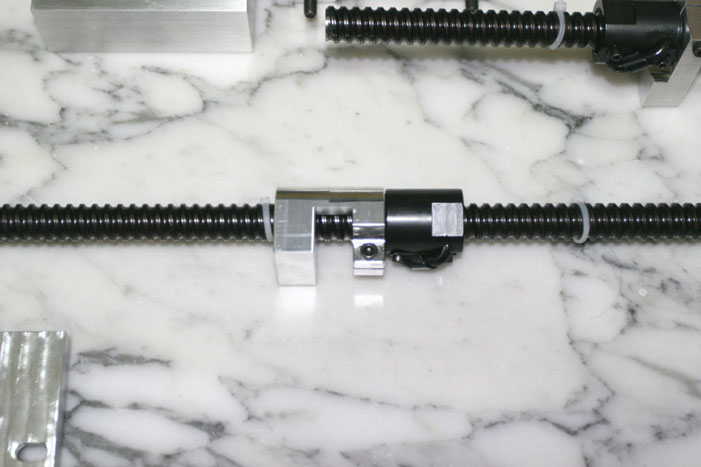

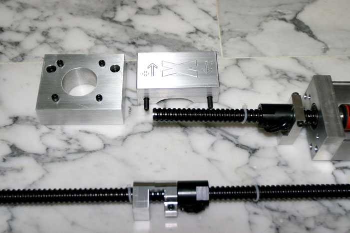

          Heres some shot of the XY CNC hopup. It was delayed for a few days because the X Axis ballscrew shipped comes with a ballnut insert in reverse way http://www.daddyhobby.com/forum/atta...chmentid=37666
          The ballscrew in the middle should have ballnut facing the other way round Took me a few hours to took out the ballnut and reinsert all the balls

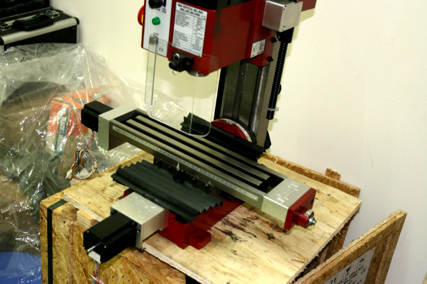

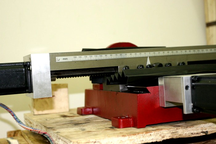

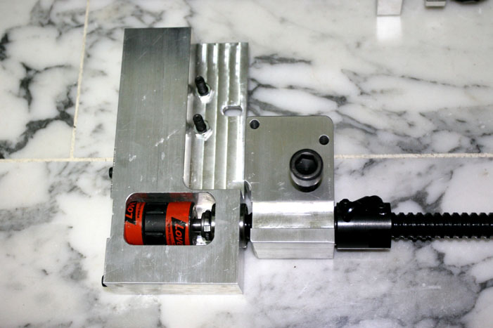

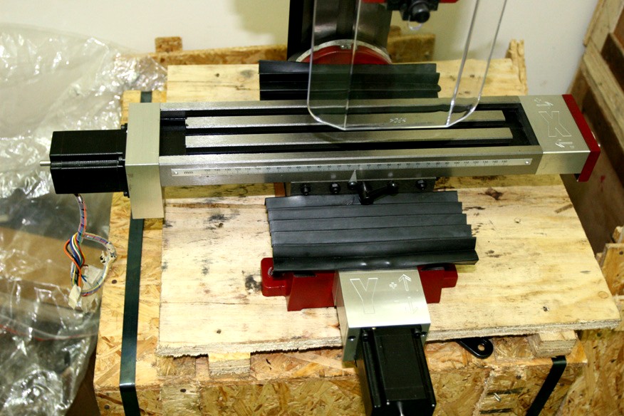

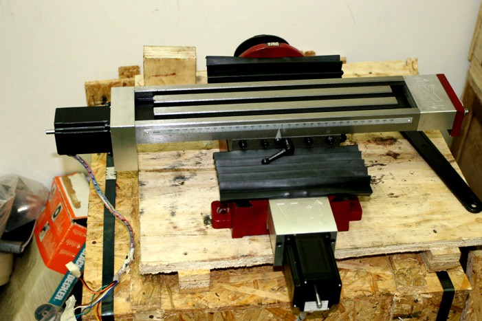

          Anyway, heres some pics on my progress <br> <br>

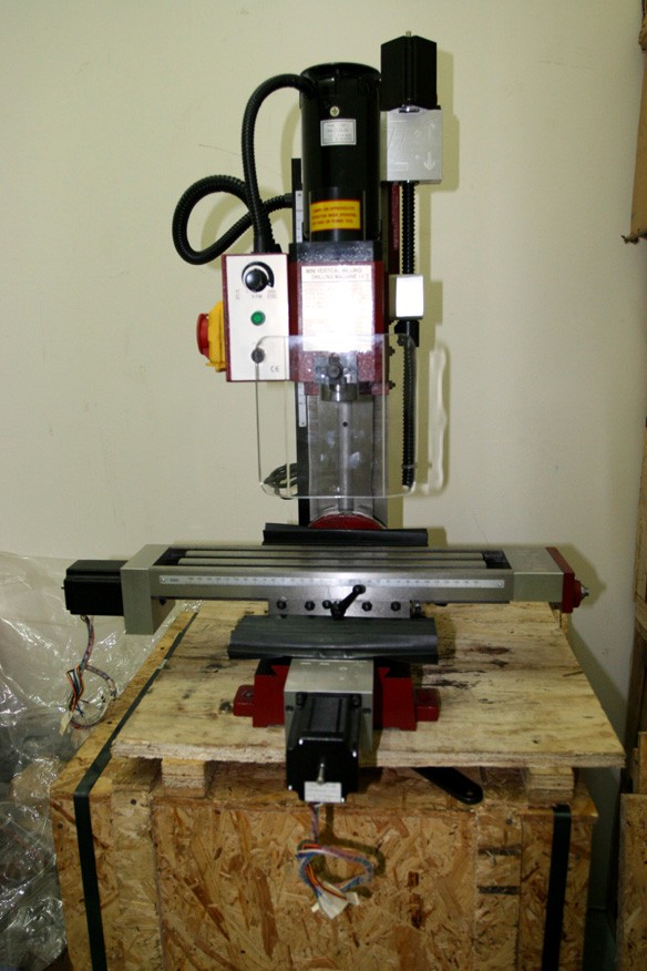

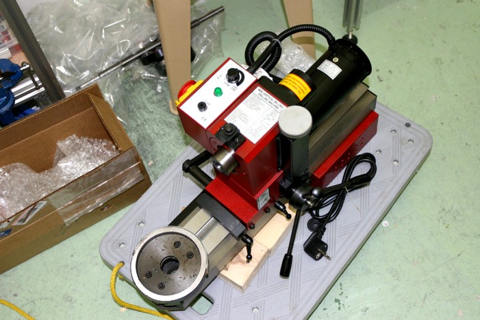

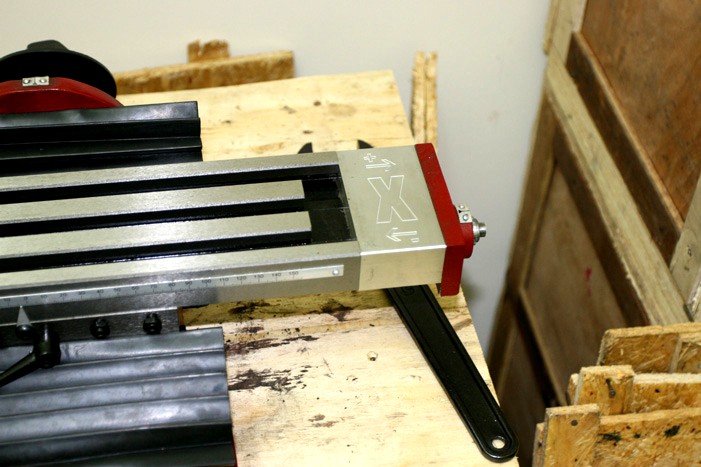

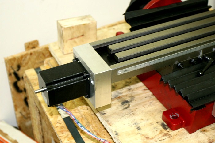

            Some more here, with the mill head dismantled. <br> <br>
              cool bro!....erm..where you gonna place the X2 in the end?.....on some special bench?...
              wah the headstock damn heavy right????!!!
              anyway cool job man.......show us more progress pics....

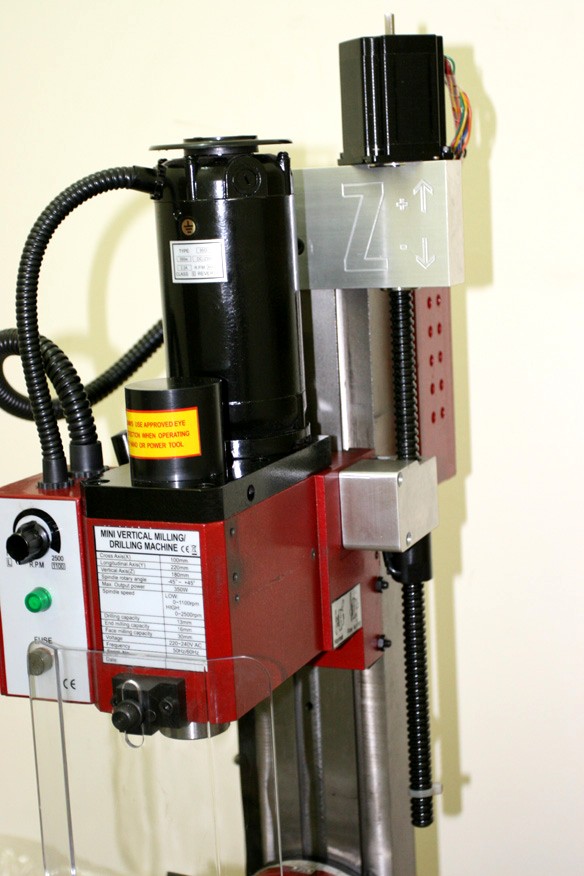

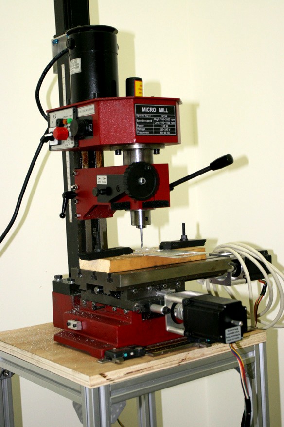

                Some progress on Z Axis
                Check this out :- <br> <br>
