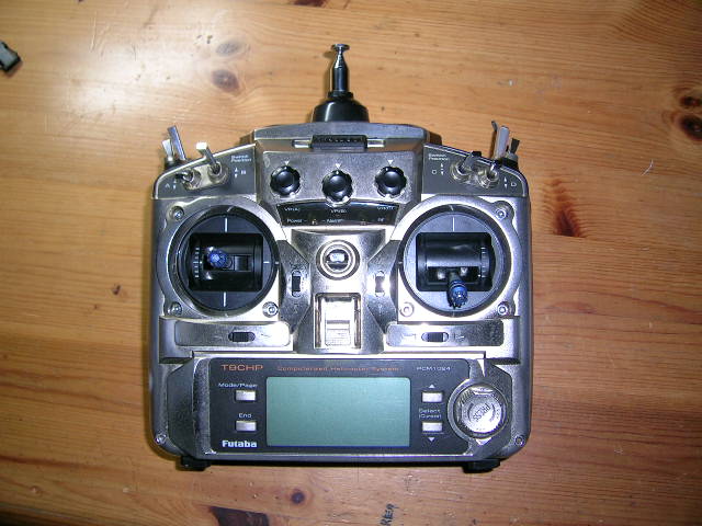

    Hi, i would just like to share with everyone how i changed my Tx from mode 1 to mode 2.
    This is my Tx b4 changing.

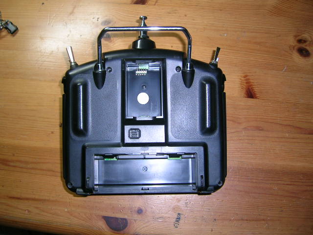

    Step 1) removed the 4 screws at the back.
    STEP 2) Remove backing.
    as seen are the springs for the left stick the the friction thingy for the right stick
      STEP 3) remove friction thigy from the right stick and spring from the left stick.
      Displayed is the parts removed.
        STEP 4) repalace everything it the "other side" of the Tx
        *the most difficult part is replacing the spring
          replace backing. ALL DONE! save myself from going down to SHS and paying them alot of money!

                9CHP`s spring so easy to put back?
                i use 1/2hr to put back my spring for my skysport 4...
                maybe i no skill... any more tips when u put back ur spring?
                  buy bent tipped tweezers... this are available cheaply at almost all bookshops and good mama shops...
                  The screws control the height and tension of the spring. So when u r putting the spring back in ... unscrew the retainer so the lever holding and stretching the spring is at its minimum height.... I always use 2 tweezers..... try to do everything inside a nice big tray which is of a bright colour... u dun wanna be charged $10 for one of these springs....

                    YAH! i help my fren with his skysport 4 before. mymy, the space is so small to work with. cant even put tweezers in. luckily 8U and 9C space much bigger, at least can see. I took a few hours to replace skysport spring, this one only 5min.
