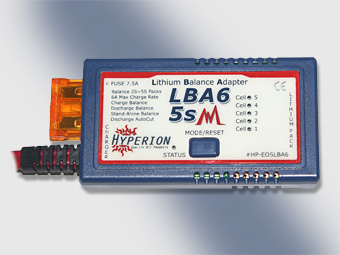

    Hi
    Anyone tried or know if the hyperion eos lithium balance adaptor can be used with the Prolux 1-3 cell Li-Po Charger???

    I have the balancer but using with triton. Think shouldn't have a problem withe the prolux charger.
    The balancer is pretty good... very sensitive and balances each cell to 5mV. U can just plug the balancer into the prolux jacks to balance charge ur lipos. Can also be used as a standalone unit to balance discharge ur lipos.
      The balancer can be used with t15? How fast can it discharge a battery?
        Yup i think can be used with T15. As a stand alone, it discharges the higher voltage cell to similar voltgae to the rest of the cells. Depends on how unbalanced ur packs are in the first place.
        U can use it (in connected mode) with the T15's discharge function to speed up the balancing. Not for the prolux though.
        Waht i do is i will plug my battery in after a flight in stand alone mode normally at the field. This will balance the cells after discharge. Then i will plug it into my charger and balance charge the pack. I'm thinking at least it will be balanced prior and afetr charging.
        But then again, not sure what the benefits are also... guess just peace of mind that ur protecting the batteries. Pretty re-assuring to see blinking lights though

            but 1 question. usually how long does it take to balance a 3 cell???
            Multiplex Parkmaster 3D
            Tarot 450SE V2
              Any time from 1 sec to 10 mins depend on how unbalance ur pack is.
