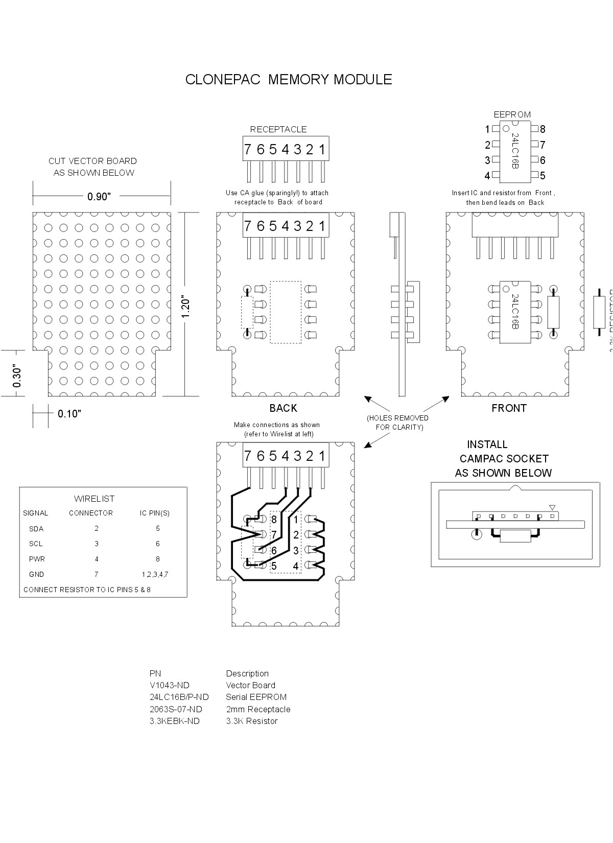

Saw someone posted this in Market Place but think it not kinda worth it. So here something to share with you guys.
From Farnell the 24LC16B cost <$1.50. The Vero board & resistor should cost <$2.00. Connector.... dunno how much exactly but should not be >$5.00. Wire should be able to get free somewhere right??
So all in all plus sometime in soldering everything should be under $10 bucks!
Make as many as you like guys
