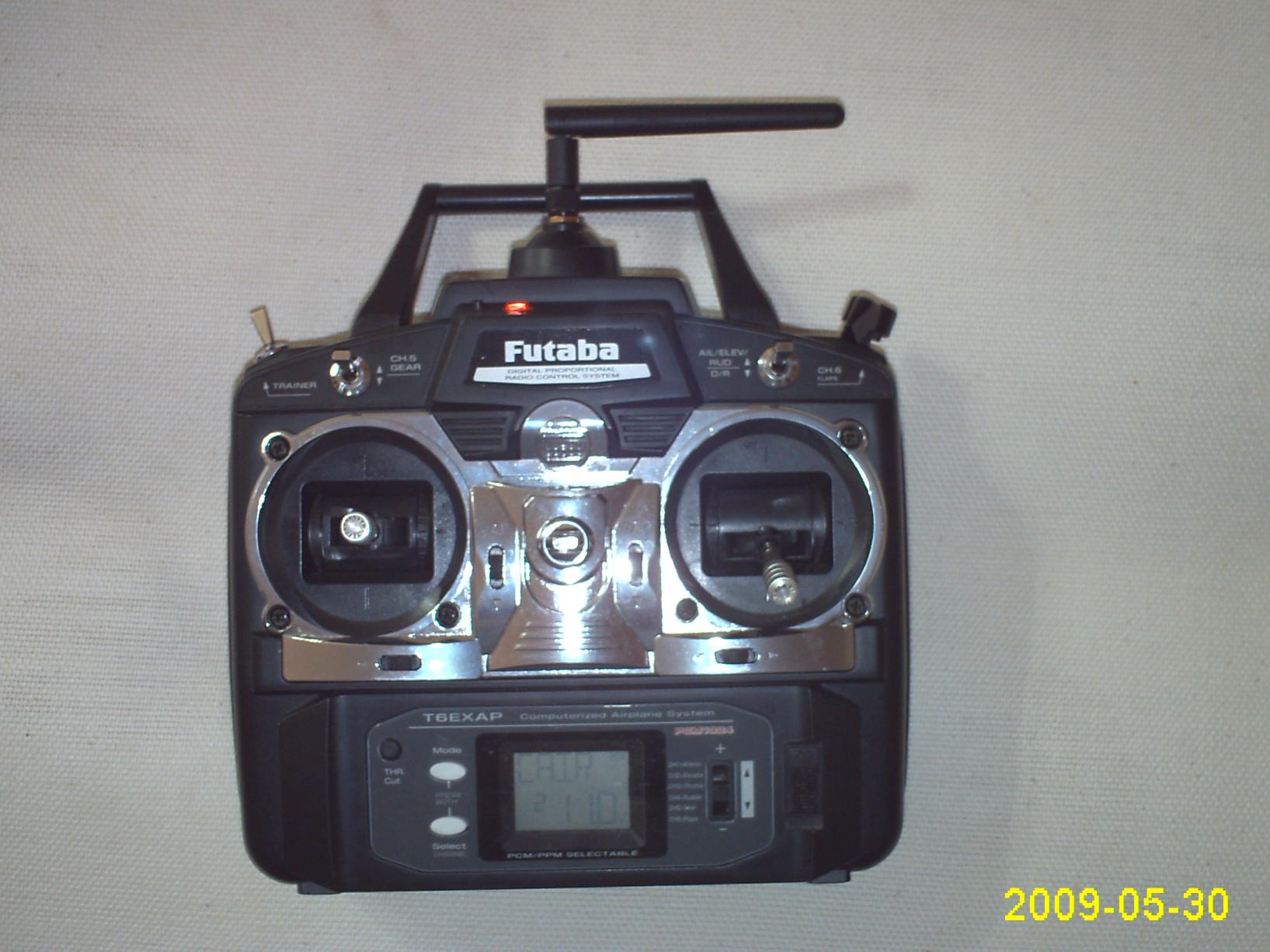

Successfuly converted 72Mhz Futaba T6EXAP to 2.4G
Corona 2.4G Futaba module was used for the conversion.
The module PCB mounted inside the Tx case and replace the antenna with the 2.4G antenna. The Bind button and LED placed in the top front of the Tx
