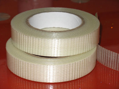

                        btw, I saw this video where it looks like the purchase paste some transparent tape on the ailerone.....
                        What is it for? is it to strengthen the ailerone? anyone try this before? Just normal transparent tape will do?

                          Basically they use the scotch tape to prevent tearing on the ailerons but I don't recommend scotch tape as it will peal off easily. If you want get the 3m tape. Is Matt and translucent in color. Sorry no pics to show.
                          Enjoy your maiden flight.
                          Just a piece of advice as my mentors advice me..... Practise as long as you can on the sim.

                            You this instead
                            Picture taken from JetHobby website

                              Oh cool,
                              I purchased that tape already
