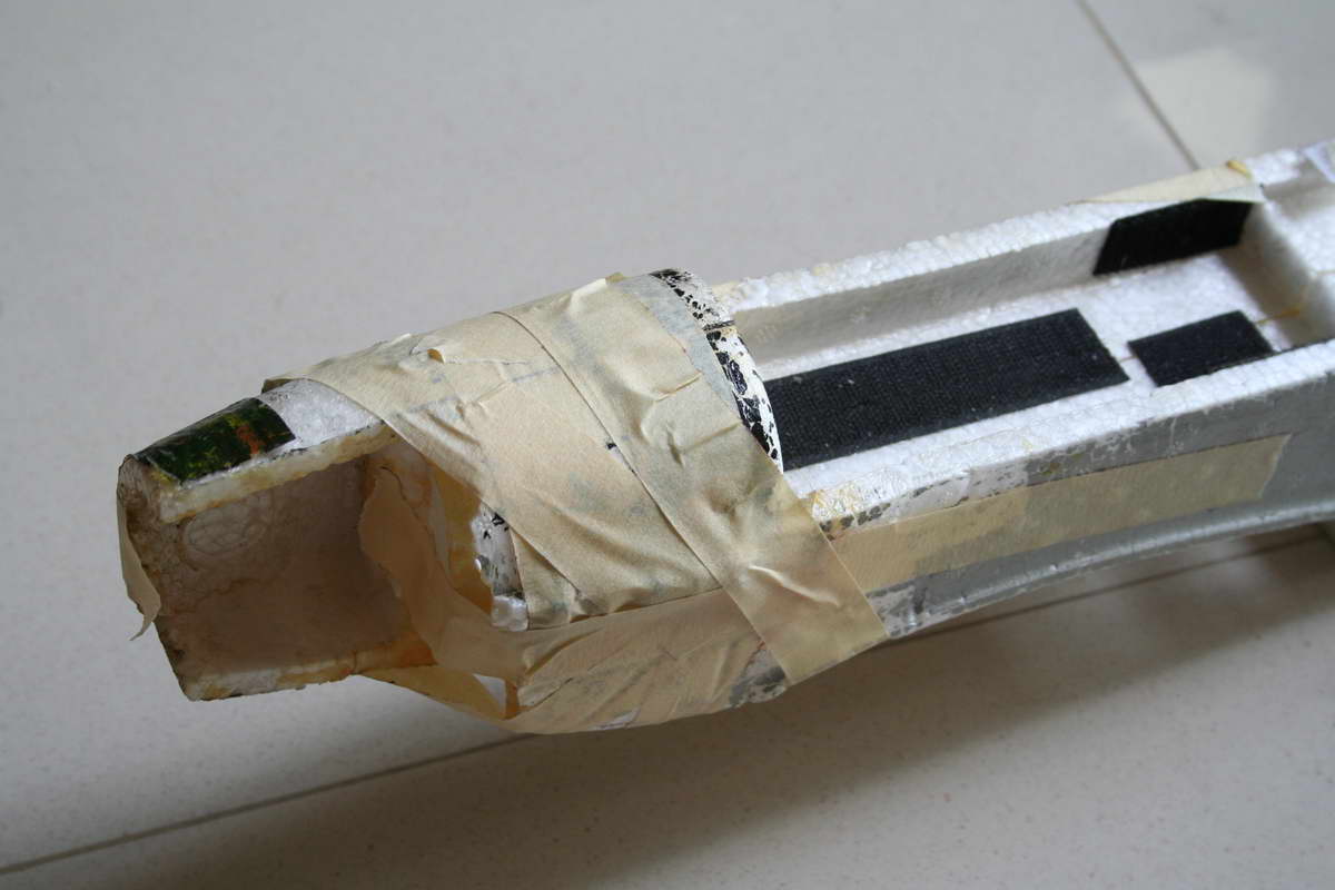

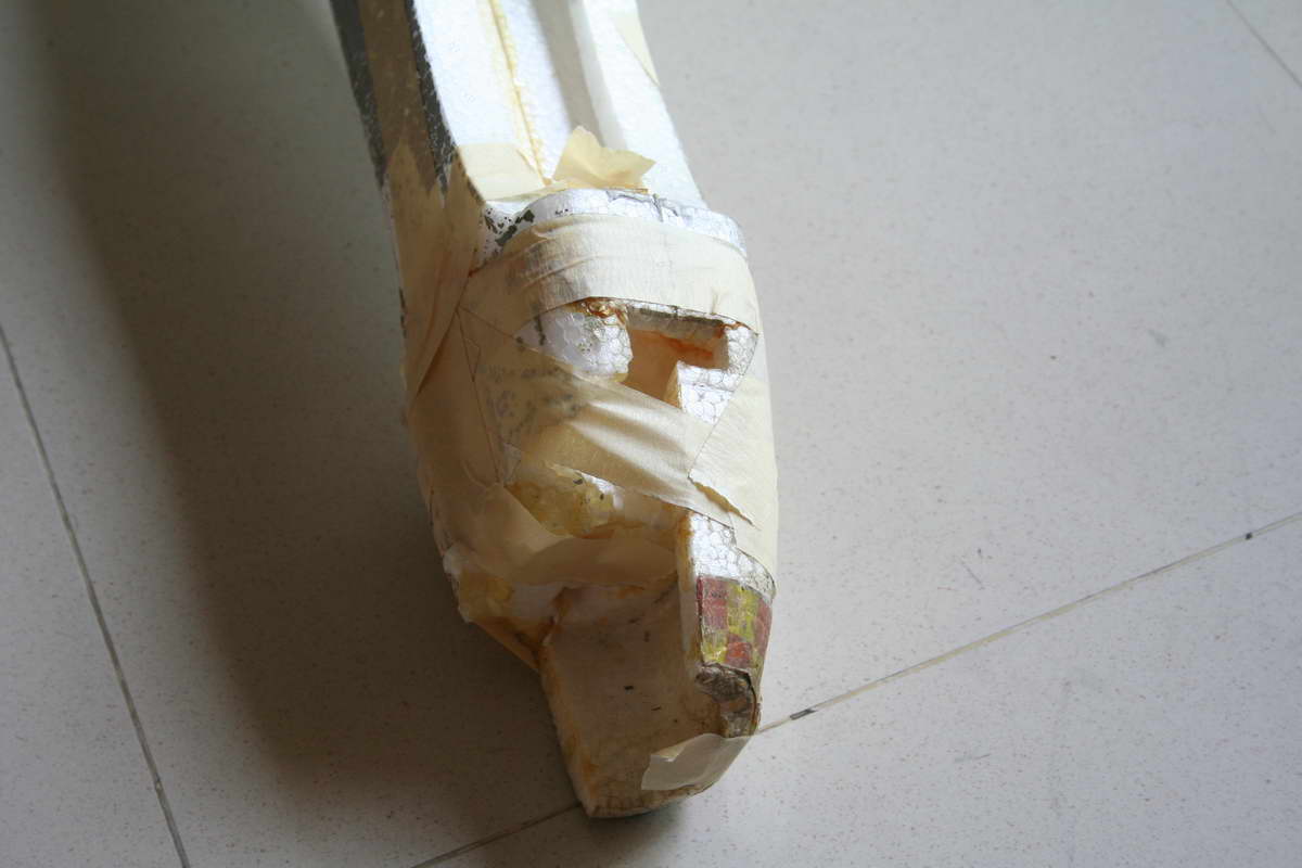

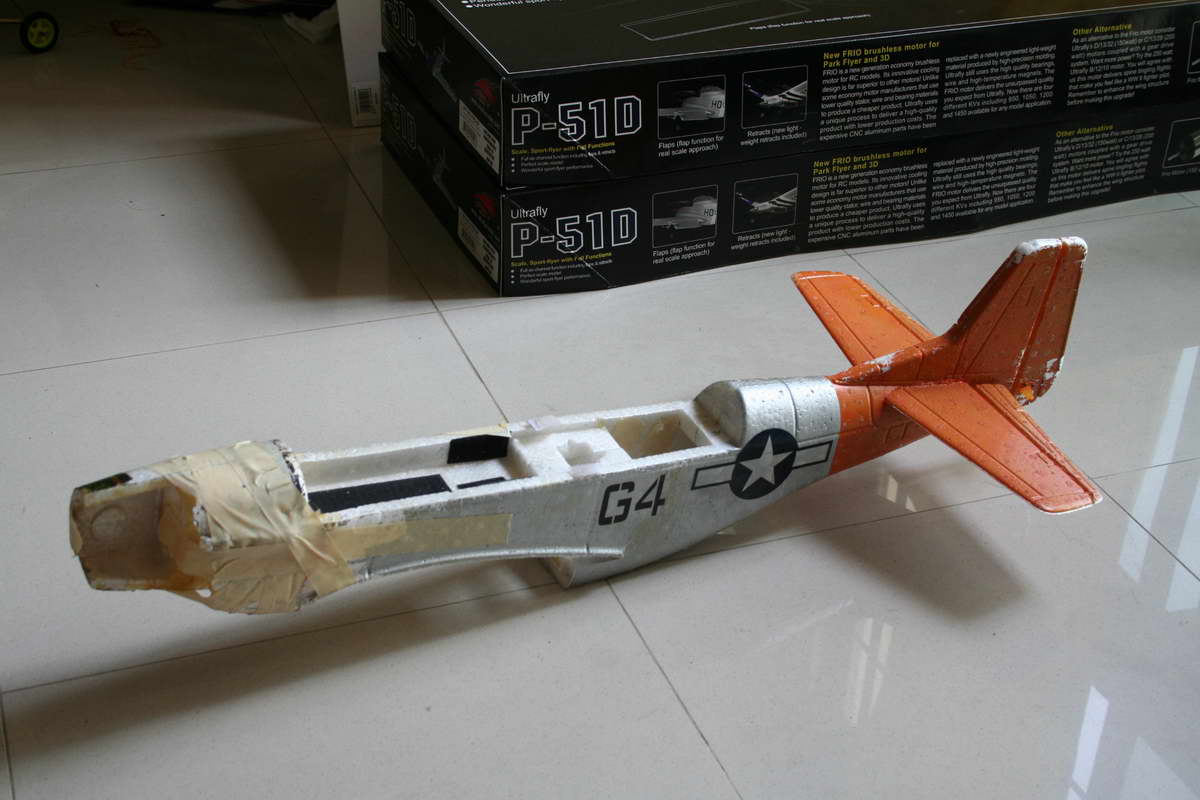

    Here are some pics of a EPP Mustang P51D repairing for a bro!
    Damage not too serious, however, seems most planes such as GWS or other brands breaks at the weakest section between the nose and the wing mounting area.

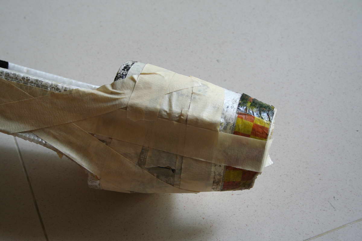

    Epp foam is easy to repair, provided you still have all the crashed pieces with you. Just put them together with PVA glue, use masking tape join them in place. Make sure you give it a pull to tighten joining pcs together.
    Still plenty of time to aligh the pcs as it dries very slowly (~2hrs to dry up outer surface, >5hrs to fully dry internally) For me, I put it under the sun near the window to speed things up

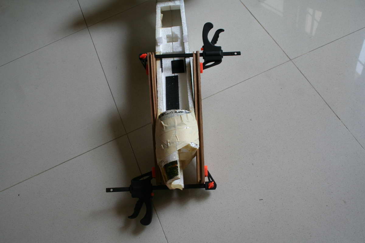

    Upon taping all the pcs together, use clamps to apply light forces ensures joining surfaces adhere fully.
    If you use epoxy, well, may be heavier but much stronger then the EPP foam itself which is not necessary except for selected areas such as motor mounts.
    For me, I usually use PVA for the whole plane.
    The PVA glue also dissolves in water when in liquid form, you can safely use your fingers to run them over gabs etc.....
