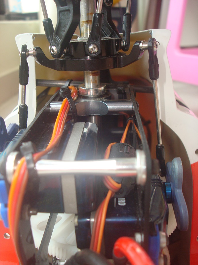

          Swap the blades around, tracking issue solved.

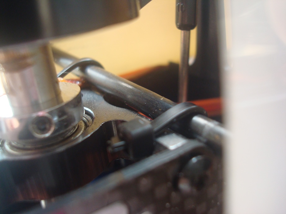

          Did a little mod, one carbon rod cut to size and two cable tie. Test flew it this morning and its vibration and shaking while in flight was resolved!!! Now can do the details.
Name:	CG 500 022.jpg
Name:	CG 500 023.jpg
Name:	CG 500 024.jpg

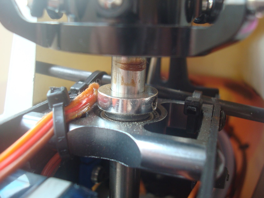

            Your cyclic servo wire is too close to your motor shaft collar that it grind it untill the wire insulator almost gone.
              #21
              Noted. Will shift it aside.
              Thanks.

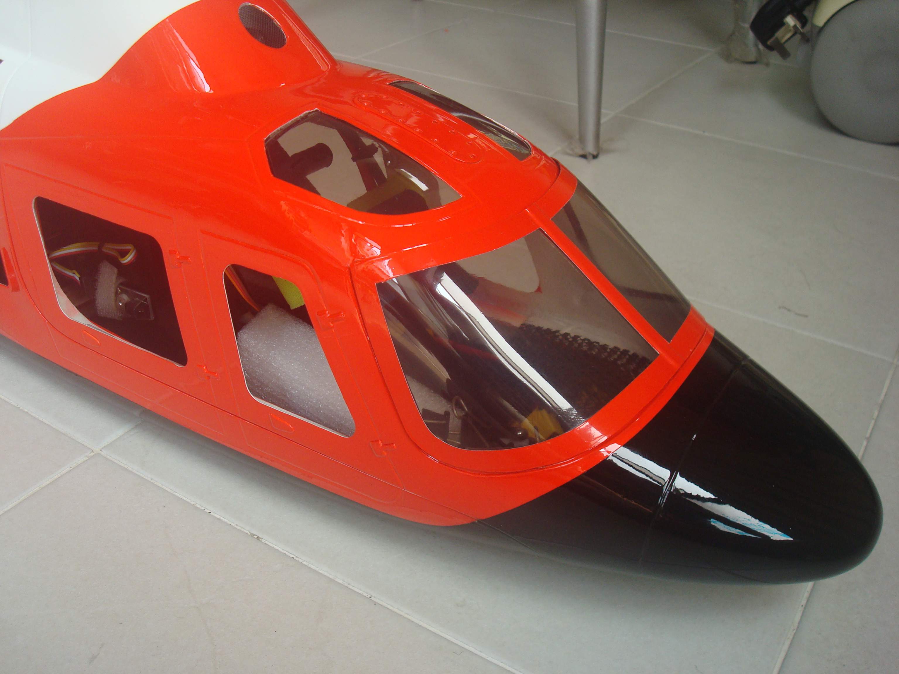

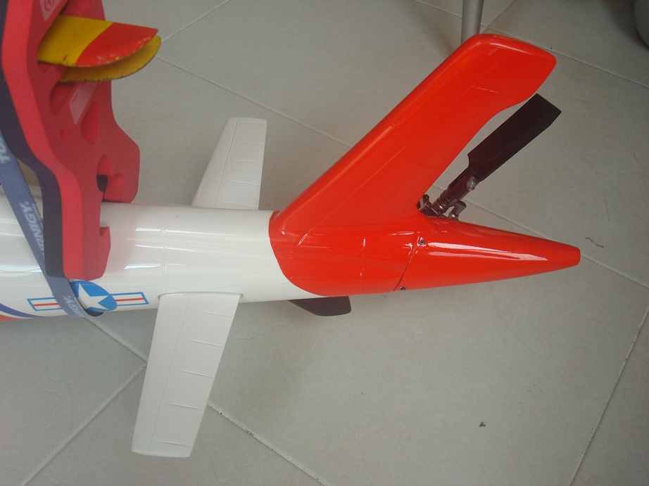

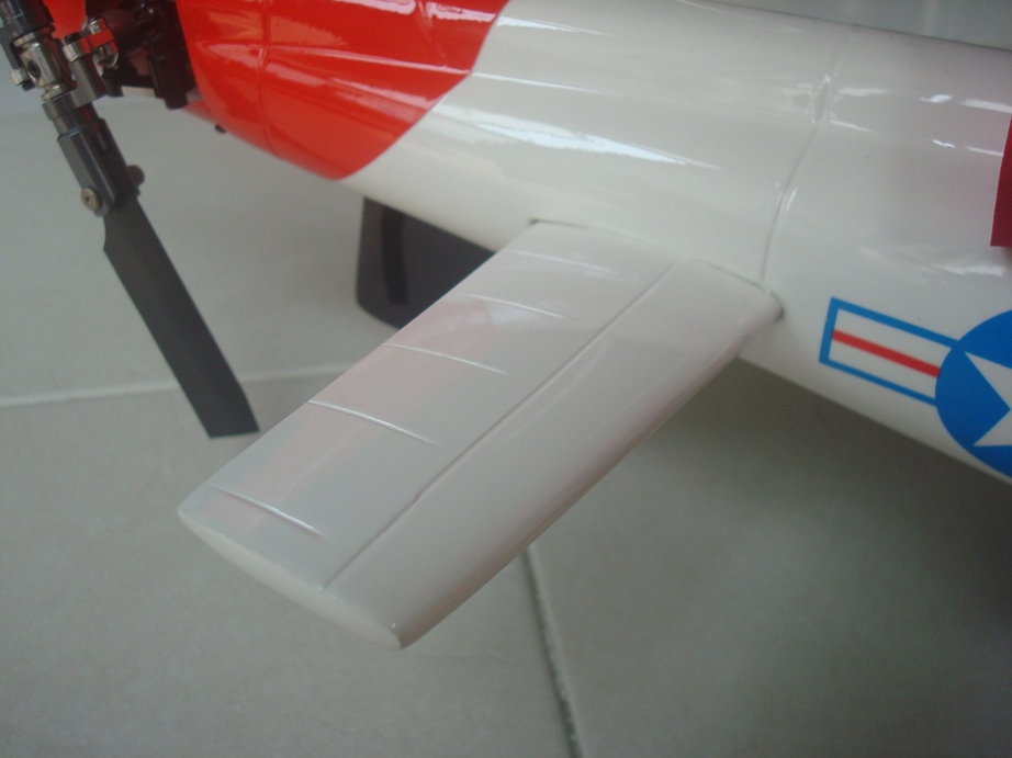

                Did the cosmetic work over the long weekend. Installed the windscreens, horizontal fins and tail cap.
Name:	CG 500 025.jpg
Name:	CG 500 026.jpg
Name:	CG 500 027.jpg
Name:	CG 500 028.jpg

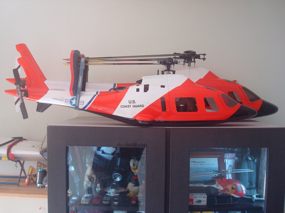

                  #23

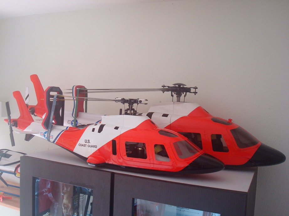

                  Now it is complete and ready for flying. Batts are coming so should be able to fly it nice and proper.
Name:	CG 500 029.jpg
Name:	CG 500 030.jpg
