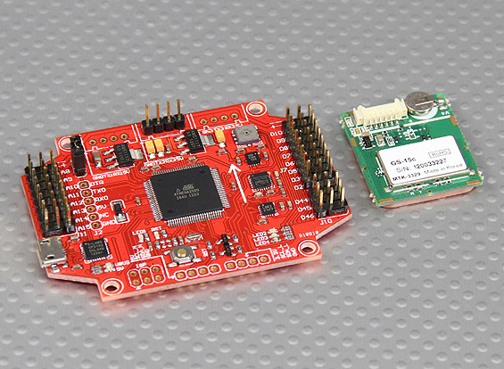

            Multiwii Pro FC - FAIL to fly
            ok after setting up ...above thread
            Load multiwii GUI and calibrate ACC and calibrate MAG
            Bring xcoptor to the field , xcoptor motor start up smothly (respond to throttle control) and decided to punch it up.
            X Coptor tends to flip to the left side, (on field check motor wiring D2, D3, D5, D6 correct connection), on transmitter check trim and rev botton check (all done) TX AUX "on" (level , alt hold , mag).
            come home check aurdino 1.0.3 for verify "no error", follow reload the software and back to multiwii GUI and calibrate ACC and Calibrate MAG.
            Second time in the field still the samething happen ... anyone know the problems?

              bro... do you even read my replies?
              Your problem was predicted immediately after you posted your so-called "solution"...
              You are using the WRONG sensors for the WRONG board.
                #22
                Kean
                What are the "sensor" should I place in this board?
                Multiwii GUI connection "on screen" detected all sensor are functional and are moving on screen...(if loaded "configh $" wrongly it will still move ?)

                  Go to hobbyking's product page where you ordered this FC... I'm pretty sure theres a list of sensors on board there. If not just google it. Use that to create your config.h file using the config.h creator link i provided earlier.
                  Haven't got time to write a step by step guide right now. let me know if you still have trouble.

                    Fill in your config.h using the sensors/gps listed below...
                    Features:
                    (MultiWii PRO)
                    ? SMD component design with Atmega2560
                    ? ITG3205 Triple Axis Gyro
                    ? BMA180 Accelerometer
                    ? BMP085 Barometer
                    ? HMC5883L Magnetometer
                    ? Servo output for camera pitch and roll control
                    ? Supports direct connection of GPS module (MTK 3329 GPS module included)
                    ? On-board USB connection for programming
                    (MTK 3329 GPS Module)
                    ? Based on MediaTek Single Chip Architecture.
                    ? L1 Frequency, C/A code, 66 channels
                    ? High Sensitivity, Up to -165dBm tracking, providing superior urban performance
                    ? DGPS(WAAS, EGNOS, MSAS) support (optional by firmware)
                    ? USB/UART Interface
                    ? Supports AGPS function (Offline mode: EPO valid up to 14 days)
                      #25

                      Originally posted by zennith View Post
                      Thanks Kaen
                      I manage to get the motor started up, by following this youtube link
                      (benefit of those that wanted the firmware are in wite's website)
                      After loading the firmware, upload and multiwiiGUI , all start to alive with full function.
                      lastly I adjust the source code in "configh $" and is responded to value setting.
                      Next is to "Test" fly, and fixed the GPS.
