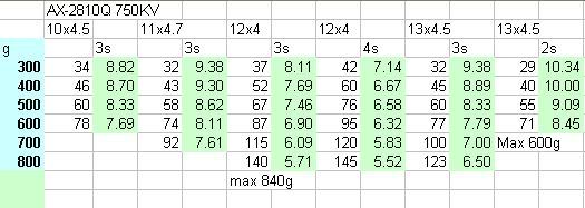

                          Take a look at some of these charts.
                          750KV motor

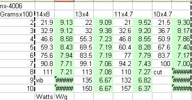

                          530KV motor that costs almost double (chart shows motor running only 4S batteries)
                          Left side is watts drawn, right side is watts/thrust which is what we call efficiency. Higher efficiency means better flight endurance. But if you are lifting a very heavy load and go for the maximum thrust, you end up with poorer efficiency. The sweet spot is to produce enough thrust to hover at 40-50% throttle. So you tweak your propellers/motors/battery voltage till you hit a sweet spot.
                          I like high efficiency because I'm doing AP and want to hover for as long as possible... so I try to get a combination that gives me the highest efficiency that generates sufficient thrust to hover my multirotor at 40-50% throttle. You may have a different goal so adjust accordingly.
