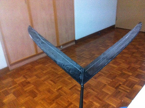

    Bady step but giant commit to building it.
    Questions

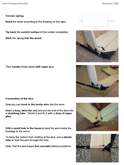

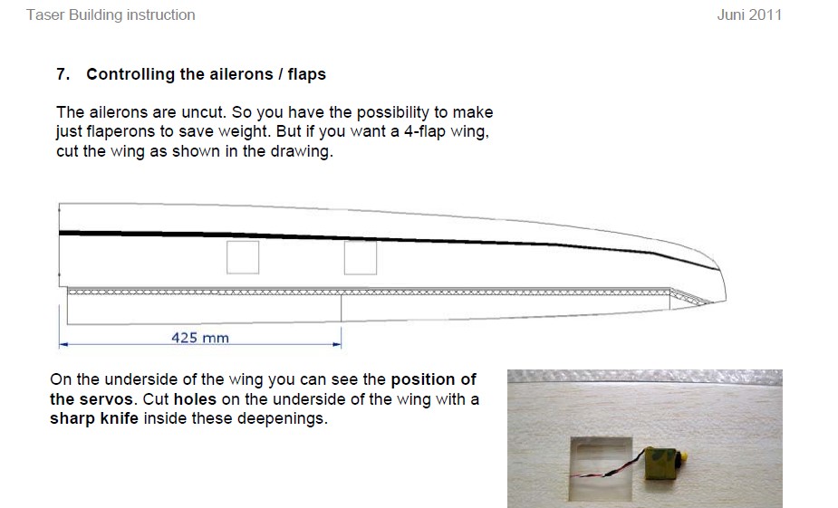

    (1) What is the ratio of flaps and alieron, as I need to cut it to separate it on the carbon model as it give choice of using just aileron or aileron/flaps ? Is it 1:2 ?
    (2) The V-tail is suppose to set up using torsion spring, which didn;t come with my kid...and the instruction shown is for non-carbon. I am thinking not using torsion spring but going direct from servo to rudder. Make sense ?

    Hi Jonathan, seeing the cash spent on such a lovely model and high end carbon I'd hate to see you add unnecessary weight to it if possible. Torsion springs are very simple to make and if it doesn't work out it wouldn't be that hard to undo or redo differently and go with an alternative method. Worth a shot for sure though.

    answer to question 1 on page 11.

    I normally do about about 30% flaps to ailerons.
    On thermal mode, I turnoff full span ailerons, instead use the flaps as camber/reflex or elevator camber mix.

    dun rush.. anything just ask..

    How about dun cut the flaps?
    Try flying with full control surface, like my blaster..
    Taser looks cool and wun be landing hot to me..
    If needed, flap the whole control surface down for landing..
    Again just like my blaster..
